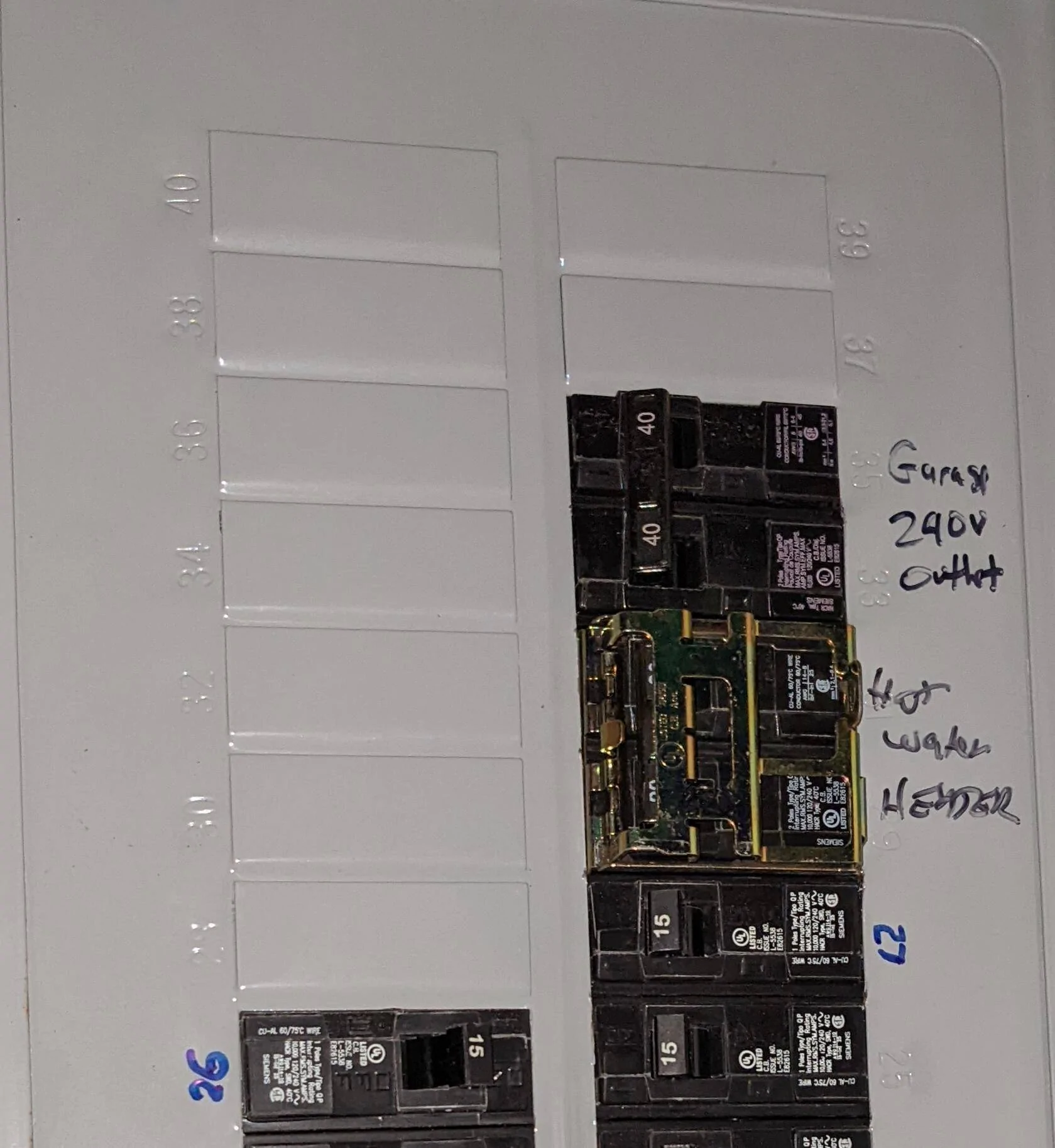

timbop
Jan 3, 2020
6,832
14,036
Mine is 20 slots but they all can have a duplex breaker so I can have 40 circuits. That is if all were only 120v
I don't know if siemens does the twin breakers in a single slot, but as I said I am good, although I will be putting in at least 1 minisplit heat pump and another electric water heater to replace a gas one. Worst case is a subpanel later on:
Ford Mustang Mach-E Electrical Service Panel Upgrade Suggestions? 1674092895899
