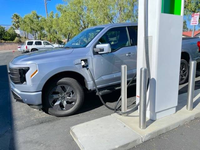

2 frustrating points for me:
1. When I used EA for the first time with my Lightning was that it stopped at 90%.
When I contacted EA, they said their chargers do not limit to 90% but 100% and to check my vehicle.
I checked my vehicle Sync screen and there is no "1 time limit" placed.
2. Both charger cables on my side, backed in were off line. Could not move it because all the spaces were used. Had to call EA customer service and gave them the charger numbers and they reset it 2 minutes.
Used the free minutes from Ford and got 90% charged.
Next time, I will be using my EA app to actually pay for the charge and get 100% in preparation for an upcoming road trip to Las Vegas.

That’s how all Lightnings work. When you DCFC, it will stop at 90% unless you override it and tell it to go to 100%. But you have to manually override it every time if you want more than 90%.
