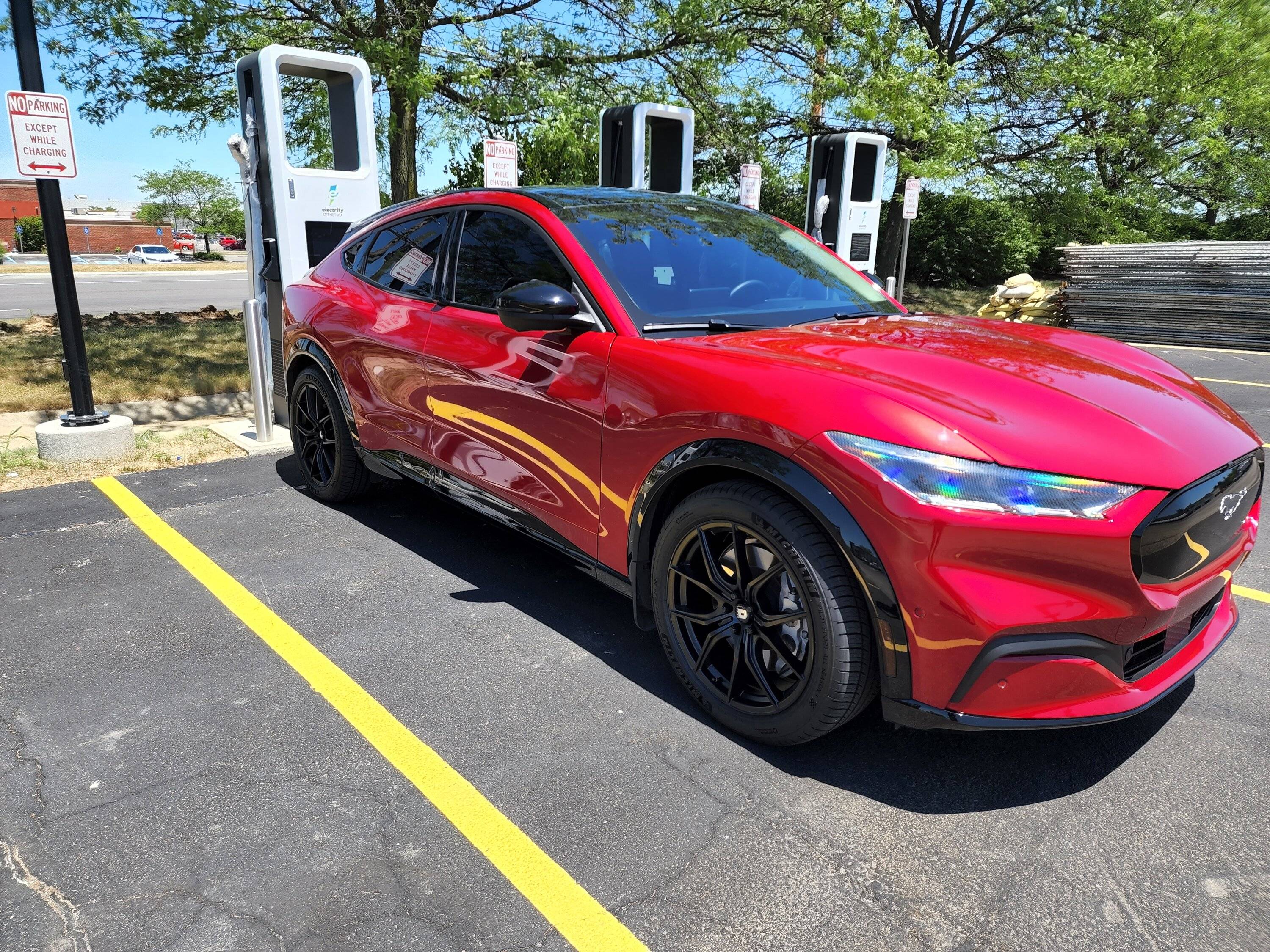

Not to be anal, but, how do you charge at EA while backed in? EA’s cable isn’t that long though I never tried.
I stopped by a station that was a brand new installation, checking in to see if it was activated yet. We're sorely short on level 3 charging in my area so when this one popped up as in progress I checked it when I was in the neighborhood.
After I parked in and checked the screen I thought, "Man, @ChuckA would really appreciate a photo right now. He won't care that I wasn't actually charging." So I took the photo and posted it.

I was just bustin' chops. Thanks for being a good sport about my comment.

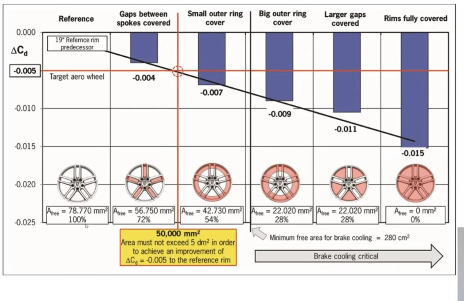

I have also attached a photo illustrating how big of a difference wheels can make. I won't take credit for that one another user posted it on this forum

Brian, really appreciate the information....2 quick questions on your post.
- How does the AFree area relate to efficiency? Does fully covered give you 1.5% more?

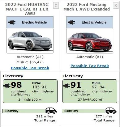

Hello, 3.7 for a Premium ER AWD is very good. I am not as sharp on this as someone like Engineering Explained.
Here is a great video with the math on how it works.
I could not find the wheel curve per tire size for the MME but consider this the CR1 AWD and Premium AWD XR are mechanically the same cars but the CR1 AWD has about 13% more range. So switch to the CR1 wheels and there you go, get more efficient tires and you could go further too. The CR1 and Premium RWD have about a 3% difference in range so it appears wheel size makes a much bigger difference when you have AWD.

I found this and its where the reference image is from extremely interesting stuff
