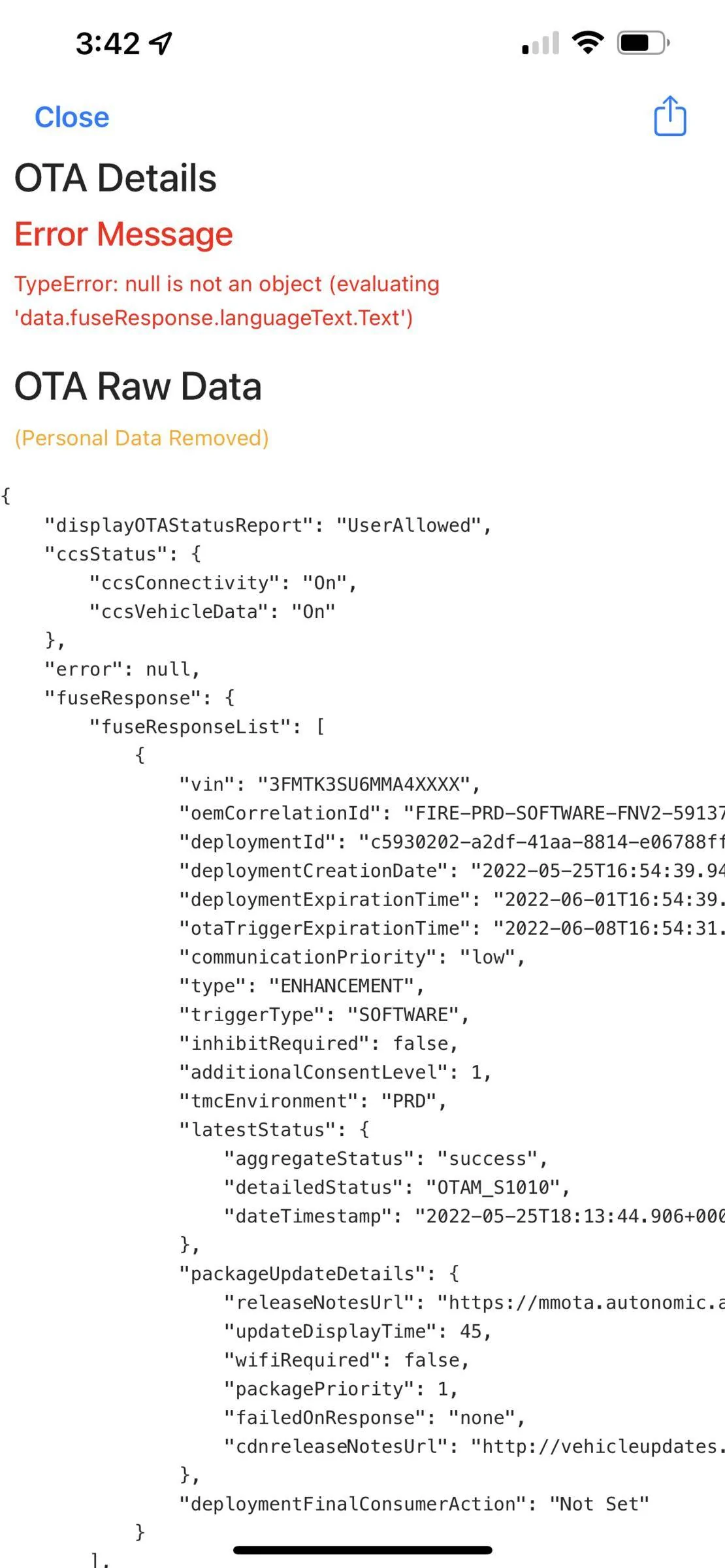

Had an update install today and the OTA page is messed up, I got the install notification though.
Lol... So the widget sent the notification?
I'm working on some bugs right now I will add checks for the errors you are seeing on the view data page.
Yeah, the update pending message showed up on the dashboard. I think since this update was a special one targeting certain vehicles it didn’t have any release notes so maybe why that error is there.
