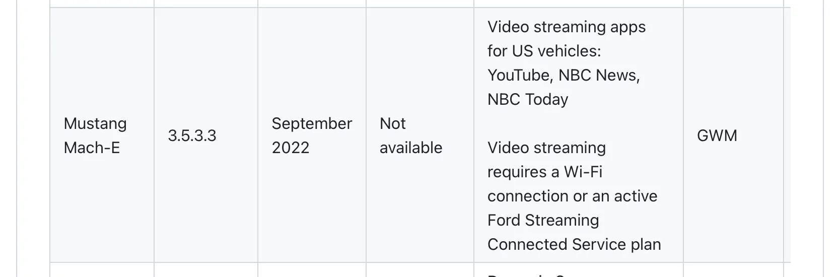

Does anyone know if you can enable YouTube? Unfortunately Canadians were not given it.
Thanks
Isn’t that in CarPlay or Android Auto?

Isn’t it under the “entertainment“ tab where the games are locate? USA located vehicles got it with PowerUp 3.5.3.3.
it isn’t in CarPlay.
Yeah, it is for me. CarPlay has YouTube Audio. Is that a general Canadian thing? There was discussion in the Lightning forum of it disappearing in 4.2.1 briefly. It’s not in Forscan I don’t think.
It could be a general Canadian thing, or it could be a dumb me thing. Not entirely sure. Although I was referring to the video streaming part of YouTube. I was hoping to be able to activate it instead of purchasing a MMB. Thanks for the response.

Canadian cars didn't get YouTube. Must be something to do with regulations.
