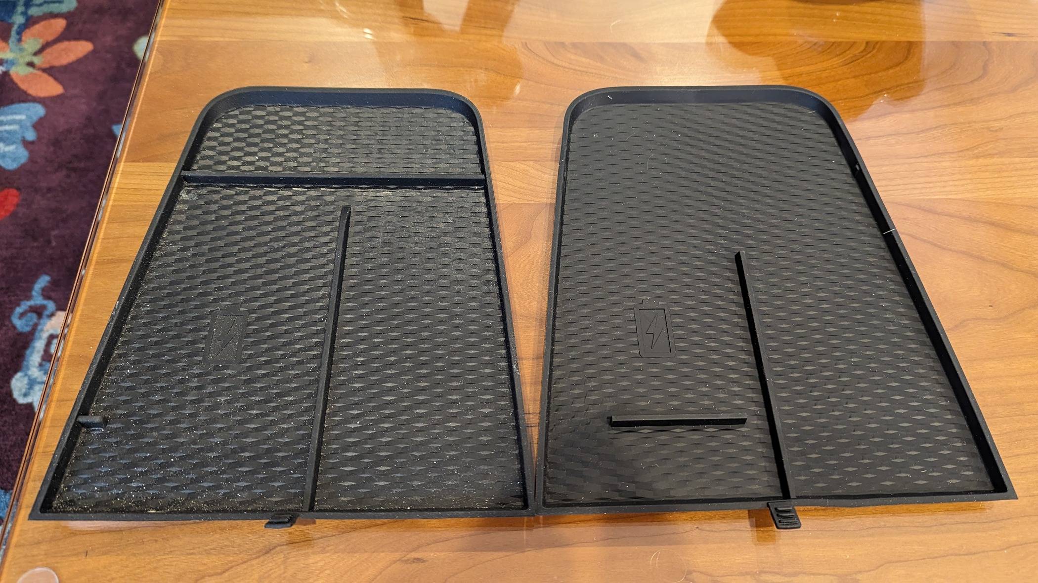

Recall 23S56 completed in Jan2024 and I just received my new charging mat and a check for $50. The 30K FP points were received about 6 weeks ago.
The only difference between the old mat (on the left) and the new mat is that the new alignment ribs move the phone forward about 1.5 in.
For those of you not slated to get a new charging mat, some careful work with a sharp razor blade could accomplish the same thing on the old mat. Slice off that middle rib so that the phone sits flush to the mat and slide it forward 1.5 in.
I've not tried to charge my phone yet (Pixel 6 Pro) on the new mat so will update when that happens. With the old mat, the phone just got really hot and the charge level actually decreased when using Maps.

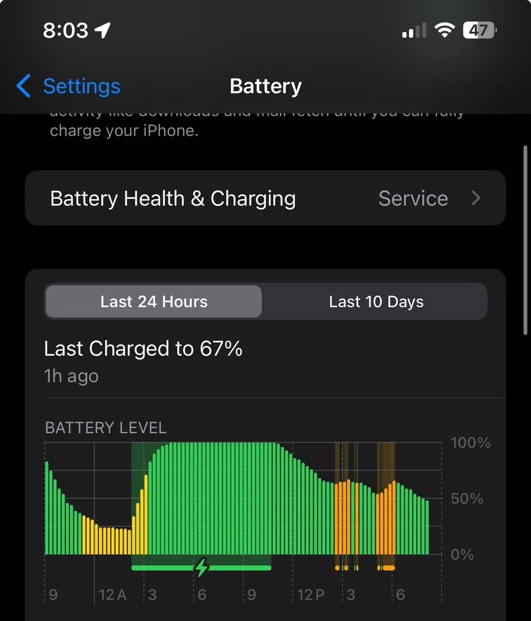

have you or anyone else who received the new mat seen a positive difference? received mine this weekend, tested it today on my iphone 12 pro max and got poor results.. notably, I had the phone wirelessly connected to CarPlay and I was using Apple Maps which seems to use up a lot more power in past experience. it wasn't a particularly "spirited" drive and there were no major bumps so I think we can rule out the phone shifting around.
charged from approximately 2:30pm - 3:30pm before CarPlay stopped that it wasn't charging. 62% -> 67%.
phone was on top of the horizontal ridge, with the bottom of the phone lined up with the bottom of the mat.
repositioned phone upside down so the camera is lined up with the bottom of the mat, phone on top of the horizontal ridge. stopped charging at approx 3:40pm. 67% -> 65%.
repositioned so the bottom of the phone lined up with the horizontal ridge. stopped charging at approx 3:50pm. still 65%.
the phone was slightly warm, but no temperature warning popped up. at this point, I gave up charging with the new mat and removed it to let it cool down.
tried using the old mat again from 5:19pm - 5:25pm. stopped charging at 5:25pm, 56% -> 56%.
stopped using apple maps but continued using CarPlay for music from 5:25pm - 6:07pm, it charged from 56% -> 67%. no temperature warning when I finished my testing for the day, still showing "charging" icon when I looked at the SYNC screen.
the battery section of the phone's settings app does show the multiple charging sessions and they actually show up in orange (slow charging occurred) so I wonder if this is part of the issue.
Ford Mustang Mach-E Goodwill Program Information: High Voltage Battery Junction Box (23S56) IMG_3231

I had similar results. Little if any improvement. I've given up depending on it and just plug in to charge.
