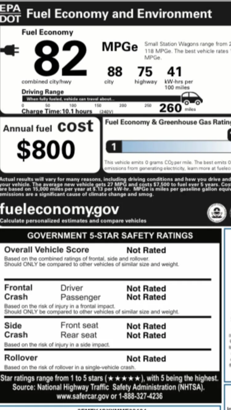

The window sticker is definitely confusing then.
It gives MPGe for city/hwy then a range. And on the range it doesn’t specify. Yes, it is more efficient in the city, but I honestly when thinking “range,” thought it was for distance driving as well. This is from my window sticker:
Ford Mustang Mach-E GT/GTPE real world range 18E58673-6EE2-4638-8087-9717EAA673AC

The window sticker of 88/75 I posted above is for a GTPE.
Ok - so you have the information you need to calculate highway range. We know the "average" range is 260 miles and the "average MPGe is 82. Highway MPGe is 75. So it is just a ratio. Highway range = 260miles * 75MPGE/82MPGe = ~238miles.

For road tripping, you'll probably only charge to the 80% cliff and leave 10% buffer. That means you'll want to stop every 165 miles or so. If you are driving in conditions that match the EPA highway test cycle.
Ok but (usable 88/41)x100 = 214.... Sooo when it says on the sticker 41 kWh to get 100 miles then I'm confused.
