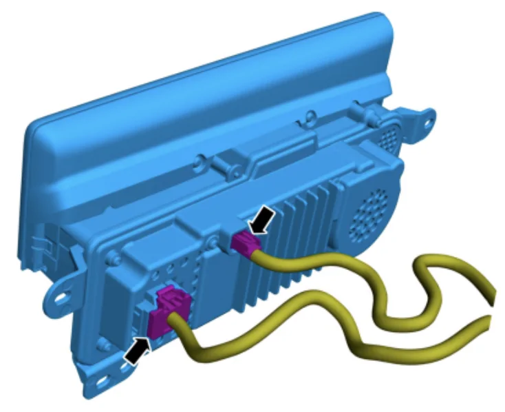

It might work to coat an offending transformer or inductor if that is the problem, but the whole assembly looks to be air cooled by a fan. So, say you could just drill a hole in the back and fill it with glue, the display would probably overheat and fail. Assuming there can still be a cooling air path where needed, it might be possible to use some sound deadening cloth (assuming the sound is not radiating from the front surface, but more from the case and back).
Probably more than one of us has been tempted to just pull the damn thing to see if there is any easy solution, but disassembly includes removing the big display and several panels, so somewhere between too risky, and probably not worth the effort for an owner to pull and study the small display (happy to be wrong is someone does it, but probably not a good idea). It looks expensive too!
The software solution might work, but this display module and its internal power supply is almost certainly an outsourced assembly, not externally programmable for something like power supply switching frequency. Also, they might have to replace several components to be able to raise the frequency too, but that is a good potential solution, to raise any internal switching frequency and/or PWM above human hearing.
Also, I think someone earlier said the internal fan itself was suspect. Does not sound like a fan to me either, but who knows until one is taken apart and operated hanging from the dash, or better on yet a Ford R&D technician's workbench (Hey Ford!) :)
