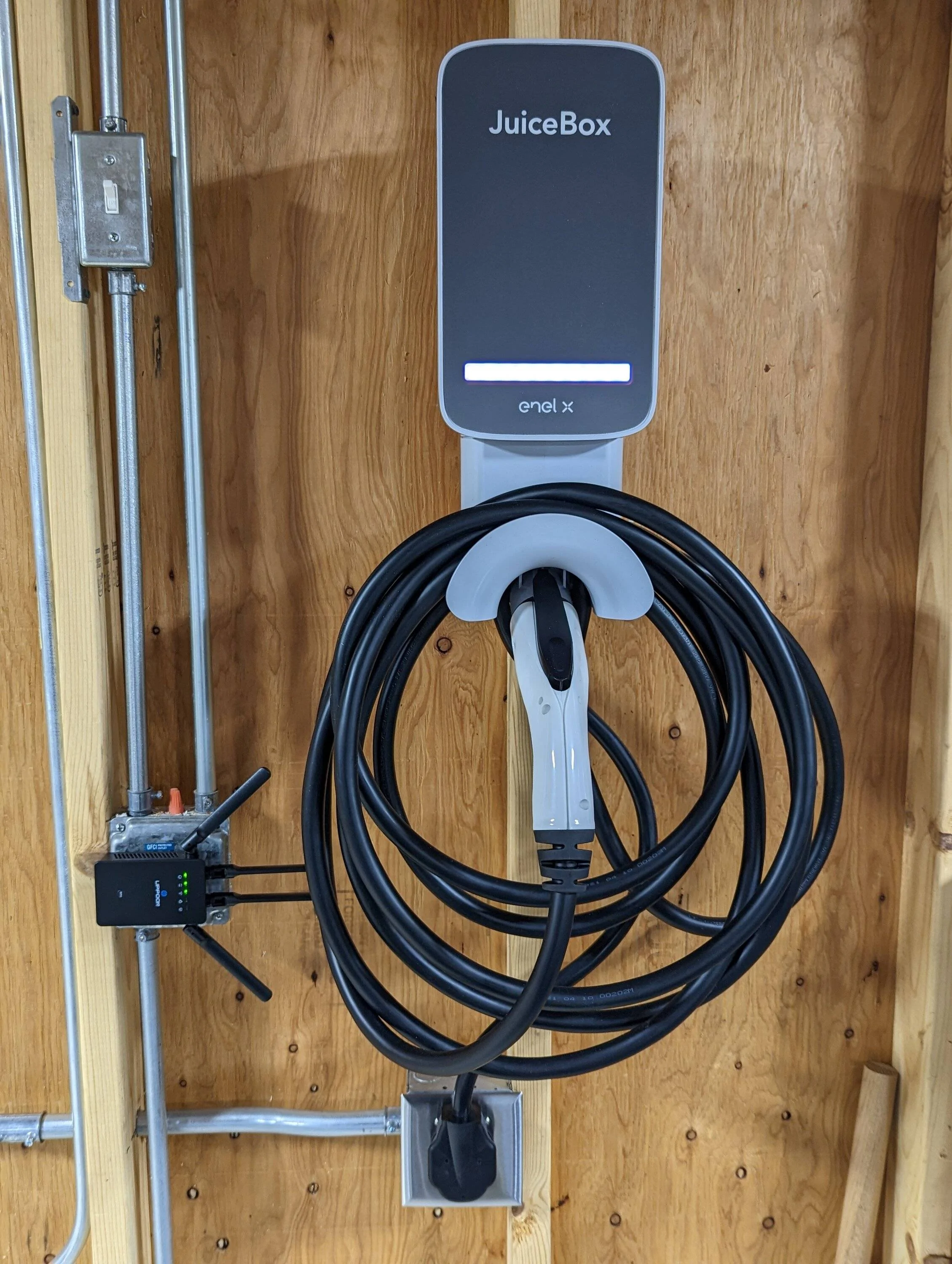

You might want to watch this video in which the experienced electrician said that EVSEs should be mounted to a fire rated wall and not exposed studs.
Things have changed since that pic---installed fire retardant insulation and drywall. Thanks for the heads up though. Also just so happens I am using a Hubble outlet ($119.00) and I will not charge all the time. But again thanks for the heads up.
De nada. Good to hear about installing fire retardant insulation/drywall.
