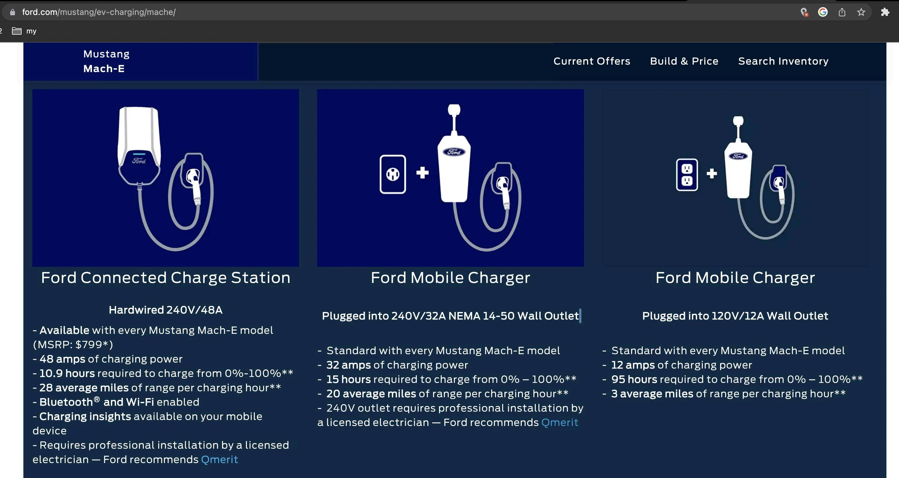

Ha, I don't know a thing about home charging until yesterday(took delivery yesterday). To keep it sweet and simple here are your options
pay very very very close attention to the numbers in the picture
Ford Mustang Mach-E Home Charging Options 1665894713527
  • Option 1 - Connected charge station, you can use any major brand (costs about $600 + installation), expensive but fast and future proof(sort of)
  • Option 2 - Ford Mobile Charger on a 240V - Not fast, but not expensive either (about 100$ + installation)
  • Option 3 - Ford Mobile Charger on a 120V - no need to discuss this
again, pay very close attention to the numbers and follow those number while installing.
Eg: Not every 240v outlet is same. Outlet may look similar but the amp is different

That's for the hardware you got to buy from home Depot. Sockets, tripper etc
If you aren’t including the parts in the cost of installation, I would budget more than $100 for them. Just a decent outlet will cost close to that, not to mention the cost of the wire.
kkgg
Oct 3, 2021
275
242
Minnesota
mach e
Yes true, thanks for correcting me. There are wide range priced similar products depending on quality
