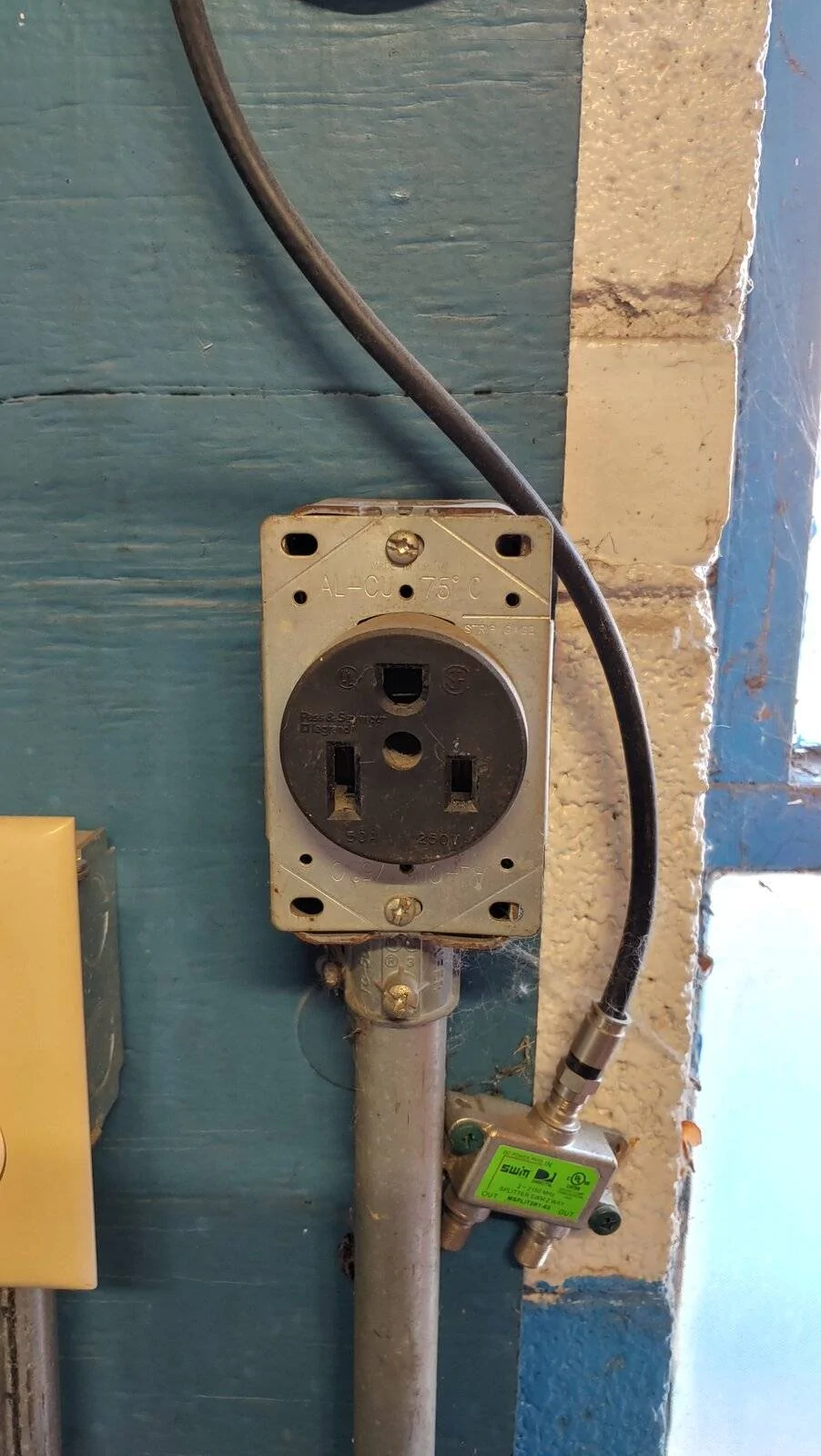

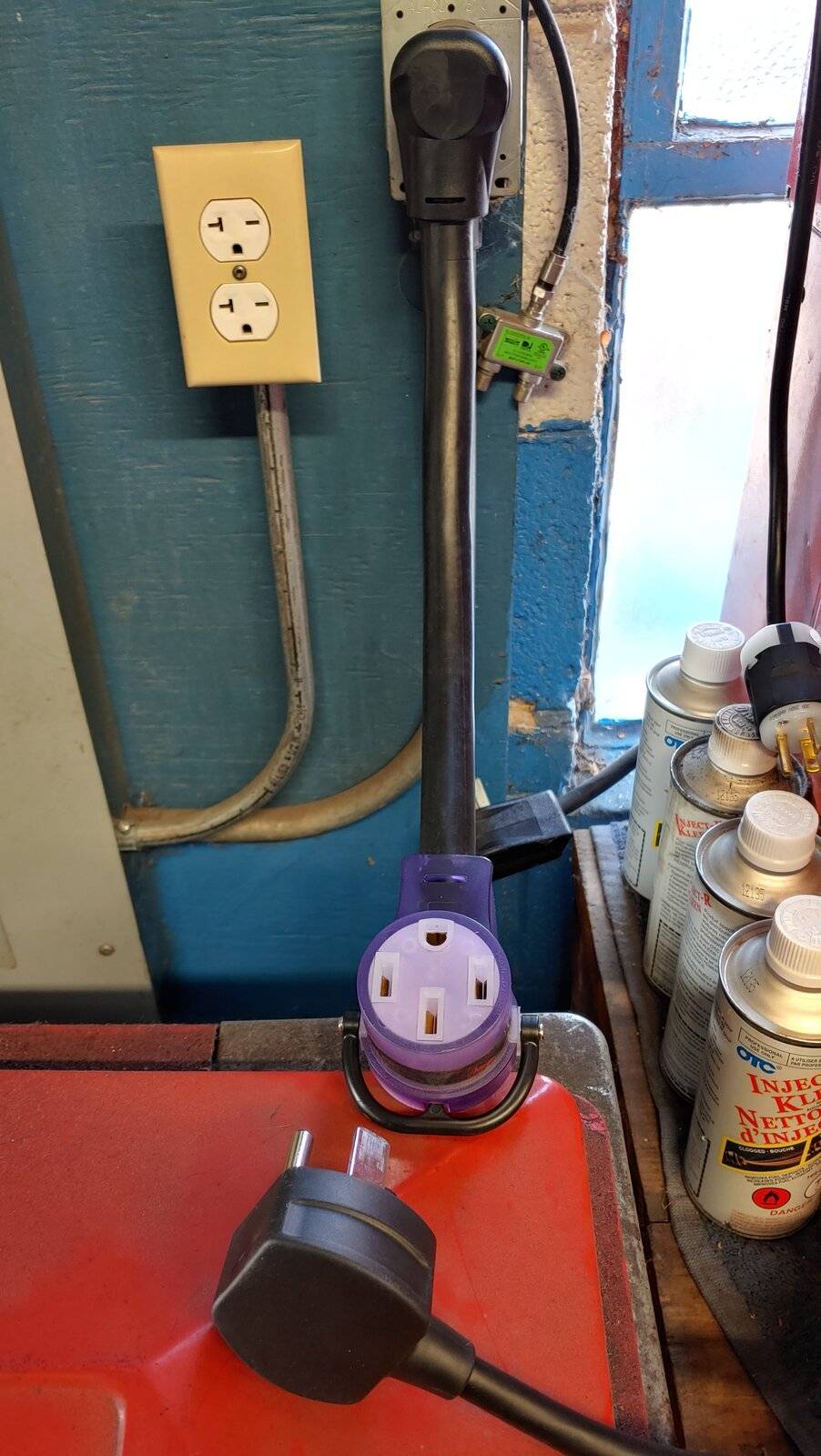

Do you know what your voltage is at your office at the 240V outlet (is it also on a 50 amp breaker)? Assuming it is a 240V but curious what the difference can be with voltage or any other variable that can cause the same car to charge at one location but not the other.
tkompass
Nov 2, 2020
37
Chicago, IL
2020 Ford F150 2008 Audi A8L 2021
Auto shop owner
Yes its a 50 amp breaker. 249 Volts. It is an outlet I use for a lift that only has 2 hots and a ground. Then I use an adapter cable to the 14-50 plug. I will tell you that the Ford charger does not use or need the neutral spade as there is no ground on that neutral spade here at the shop. At home I ran the #6 white wire from that neutral spade back to the box ground and just used my conduit for the ground pin. But at home I also tried moving that #6 white wire to the ground pin and it made no difference.
Do you know if it’s 3 phase at your office (typical for a business) and single phase at your house (typical for homes)? I am at another Ford dealer and they have an L2 charger on a 240V circuit. Car charges fine. I am beginning to think that the issue is some cars seem not to be able to charge from a single phase 240V circuit.
