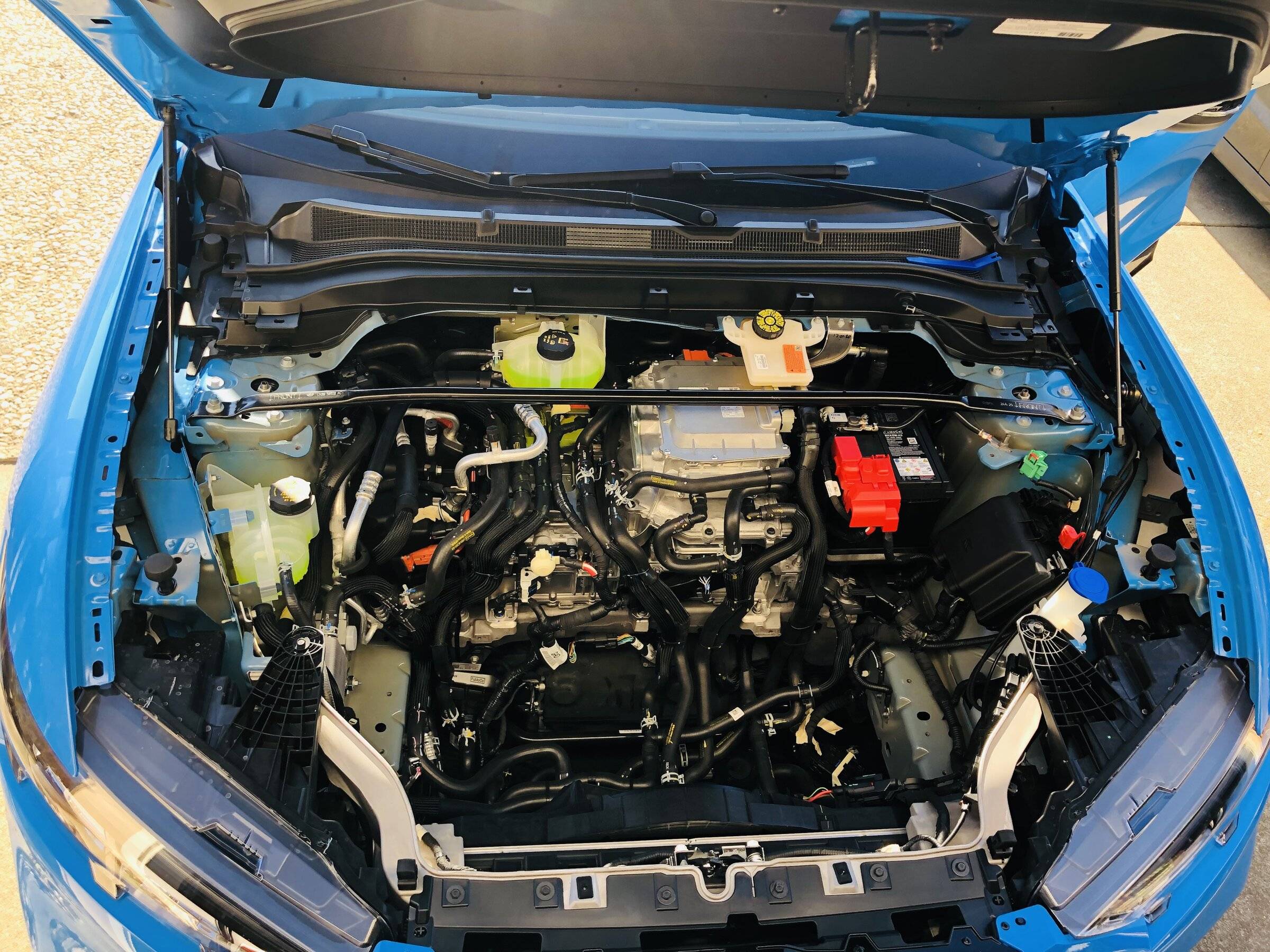

Using @HuntingPudel 's picture with the frunk out, the back of the tub rests against all of those cooling lines (tub back), the stack of modules and literally bolts (back bottom) into those two holes in the lower part of either side of that bottom most power electronics module.
