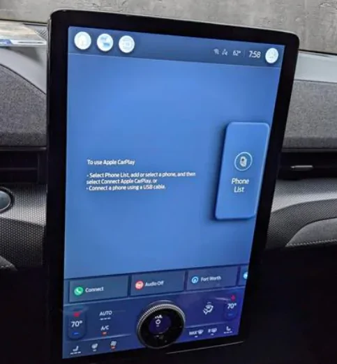

From my experience you don't need to do either of these things. There are 2 spots on my drive that Wireless AA always drops (recently that is... 1 has ongoing construction I suspect is the cause and the 2nd no clue but it's absolutely location based and consistent). I'll get the connection failed message and it drops me to this screen (random image from the internet, ignore CarPlay text):
Ford Mustang Mach-E Intermittent 'Wireless Connection Failed' using Android Auto 1692654287826
I wait a minute or so because the connection will fail if I try immediately (likely still in range of whatever wireless interference caused the drop) but I click the giant Phone List button and then tap on my phone to expand the dropdown menu. It will show that the phone is still connected but the third icon is the AA icon. I can press that and it will reconnect without force restarting sync or toggling Bluetooth.
My guess is that both of those methods that work for you work because it reestablishes the connection with your phone and auto starts AA again.
i've tried that once or twice when i go completely out of range (not EMI disconnected) and it didn't work; probably because both BT and WiFi had issues though so i'll try via your suggestion next time i get a probable EMI disconnect. ?
yep, BT reconnect is usually a good trigger since thats how android auto negotiates the WiFi connection info between the headunit and the phone. the Sync reboot is a bigger hammer but sometimes it's easier when you're driving and it's just a 2-button push on the steering wheel.
