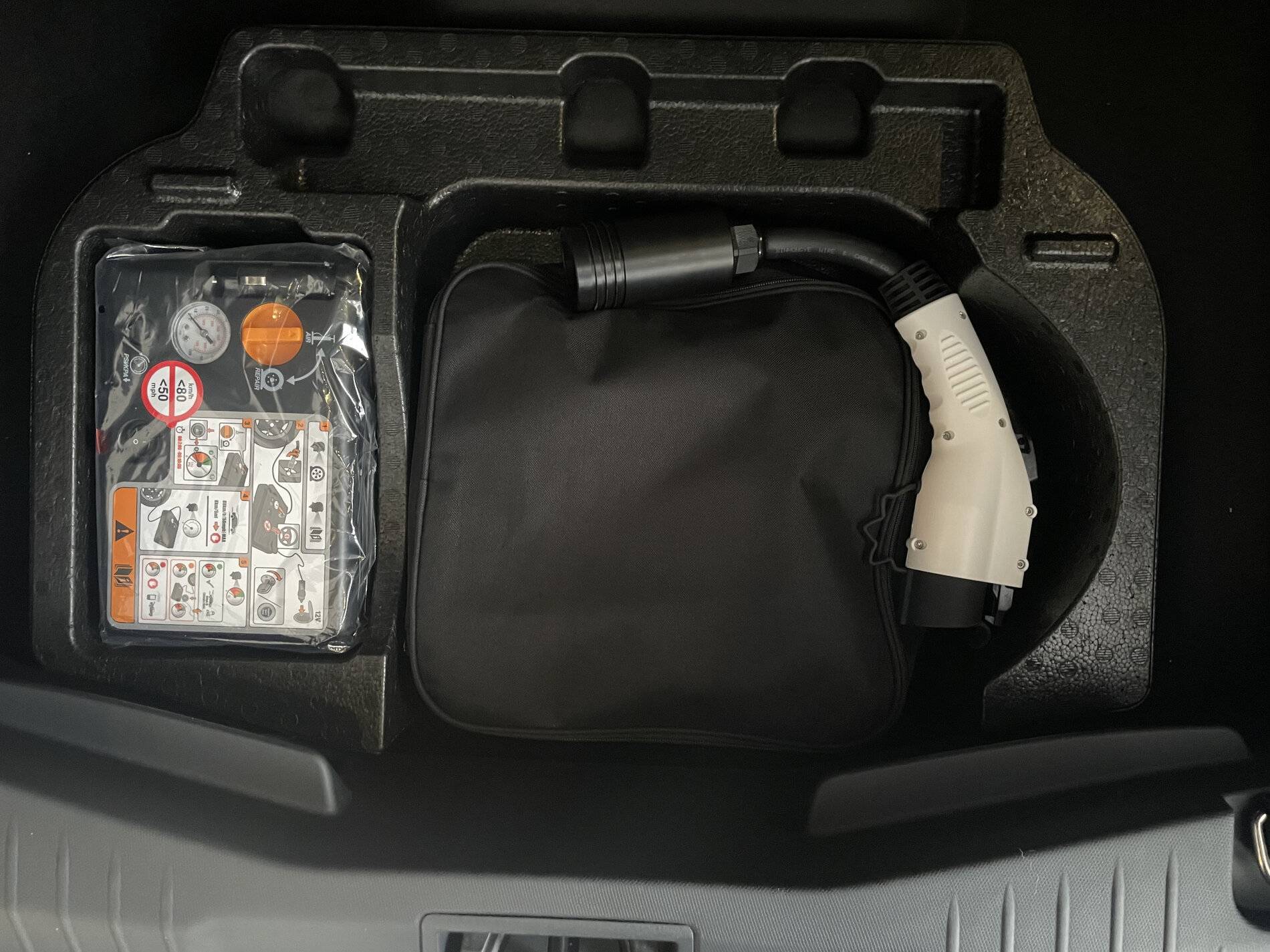

I can report that there is plenty of room for your TeslaTap to nestle in the compartment with the Ford Mobile charger.
Ford Mustang Mach-E Jdapter and TeslaTap charging adapters? IMG_6633
11,399
23,068
Thank you, Mark. That answers that question. I shall now proceed to move mine from a garage shelf to the spot on the garage floor where it'd be if I actually had my Mach-e. Along with all my other Mach-e things. ;)
