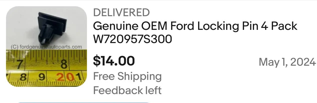

Wow...when they made that video were they trying to see how short they could make it?
And the removal of the rear and left underhood beauty panels...like magic! It took no force at all and they just lifted off! Gosh! That guy is good! :p It's either that or he's lost every single one of these:
After realizing these things are not secure once you start removing those panels, I bought extras and when I put it back on, I taped them in place?
Good idea to have spares. I'm going to stop at the Ford store and pick some up. I bought some plastic plugs on amazon and am going to make cut outs for the LVB +/- jump points and the HVB disconnect that lives more or less mid-way between the LVB jump points. I'm going to find one of the electrical kill switch stickers we use to use in my SCCA racing days and place it by the HVB disconnect. I think that will be a nice touch and pay homage to a distant past in my life. :cool: ?
Jerrytball
Jerry
Feb 21, 2024
2,172
1,158
Gulfport MS
2026 bmw i4 M50
Ford didn’t have them so I got them at eBay.
