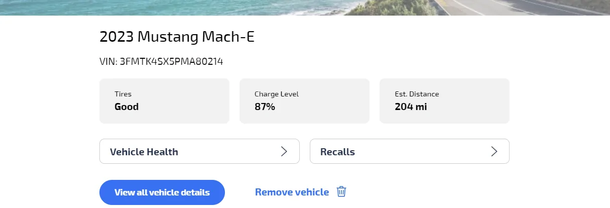

I apologize if it's posted somewhere else, but using the forum search tool nothing came up. I logged into ford.com but couldn't find the 12v battery level. Any advice on where to find it? TIA!
no worries, go to ford.com website and log in, then go back up to the right corner of the screen and click on the person icon, then on the dropdown list select "........account" (in my case it's "chris' account") NOT VEHICLE DASHBOARD, the screen will come up with 12v state of charge like this.

Got it - thank you! "Charge level" is the 12v I assume?

Yep. As explained in other threads it’s not labeled as such because it’s reputed to be a coding error by someone somewhere that switched it from the previously displayed HVB SOC to the currently displayed LVB SOC …?
The HVB SOC appears in your FordPass data and is displayed in the car.
It’s a bit convoluted.

It will show the level at the time when the car communicated with the server last time. The level will drop while the car is sleeping.

I had a short 5 mile trip 2.5 hours ago. Here is what the site showed:
Ford Mustang Mach-E Mach e dead in garage, next step 1720548683012-3s
I went to the car, started it, and checked LVB in the car scanner - it was 66%. Then I refreshed the page and -
Ford Mustang Mach-E Mach e dead in garage, next step 1720548720266-qn
So the battery lost 11% during 2.5 hours, but the website didn't show it until the car was started and communicated.

I don't think that's the 12v battery, I think that's the high voltage battery percentage. The reason I'm saying that is because my whole car died just as I pulled into my carport and started to put it into park. Dead as a door nail, luckily I was able to get all of my stuff out of the car and pop the trunk using the manual pull. I just looked online and my battery percentage is 78% just like it was on the high voltage battery at the time of the failure. Same percent as it shows in the app.
