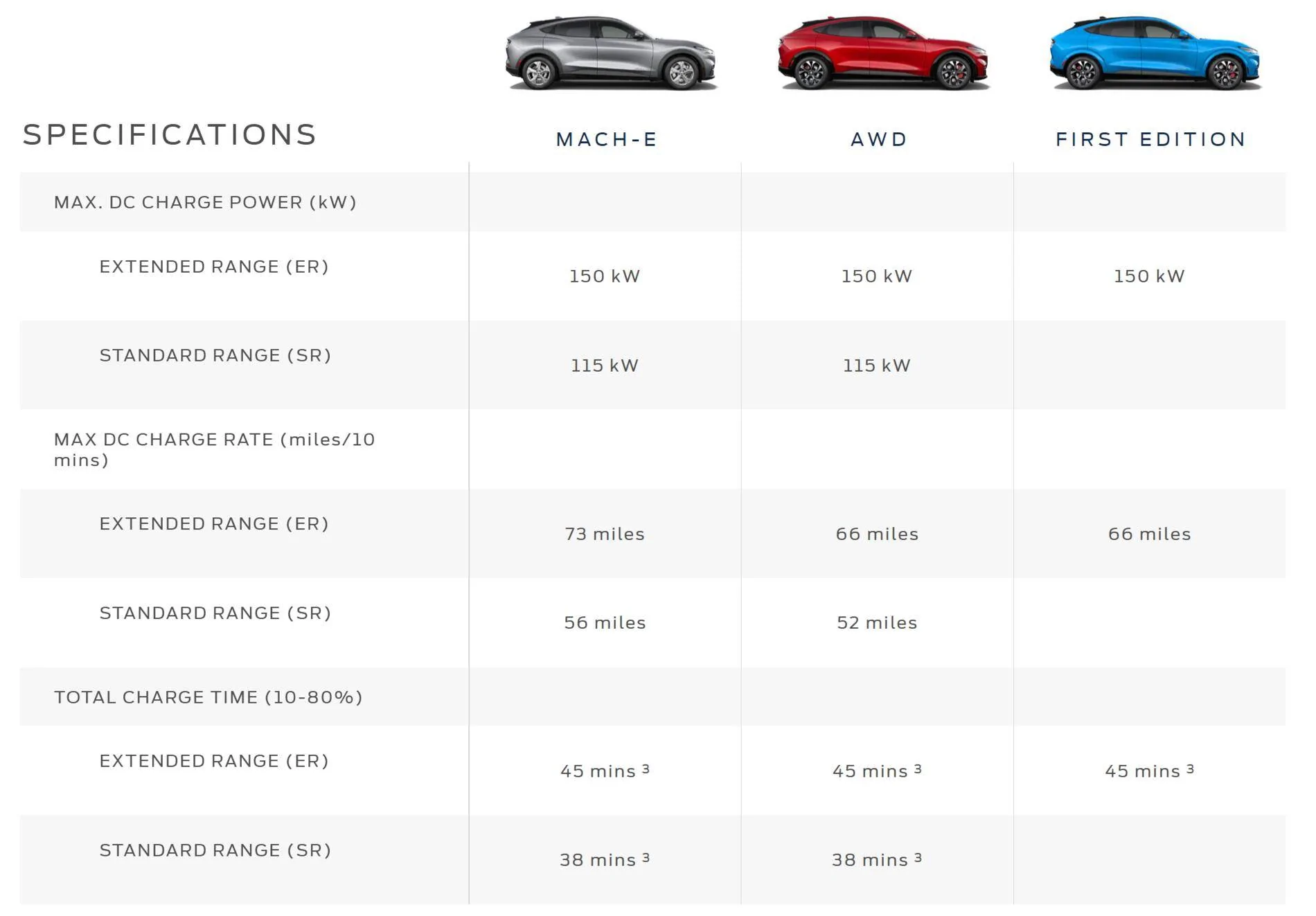

So doing a little extrapolating (and assuming)...
- Picture shows it still charging at 121 kW @ 42% SOC.
- 42% of 88 kWh usable battery = 37 kWh. However most measures assume people recharge up from 10%, so let's use 10-42% = 32% of 88 = 28 kWh.
- If it starts at 150 kW and falls to 121 there, let's just say that's a 135 kW avg for the first 42%. (It might be weighted more one way of the other, but it's probably near that.)
- 28 kWh at an avg of 135 kW = 0.21 hours = 13 minutes.
