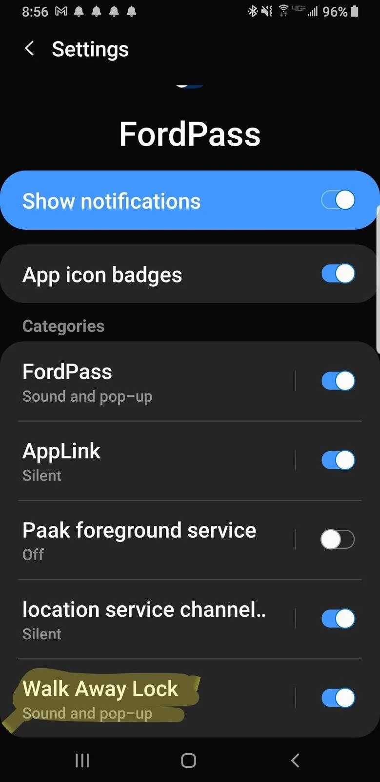

You may be encountering this bug:
https://www.macheforum.com/site/threads/does-my-car-think-my-workplace-is-safe.10402/
I'm pretty sure this has happened to me a few times... So I either lock with 7-8 and 9-0, or I look back to see if the mirrors have folded. (They fold at the same time as the door locking.)
As an Android phone user, I have never gotten the notification about Walk Away Locking. That seems to be iPhone only. So it's impossible to say we're experiencing the same thing, but it sure seems like it.
I get the notification on my Samsung Galaxy Note 8. It also appears on my Galaxy watch. Do you have it turned off in app settings?

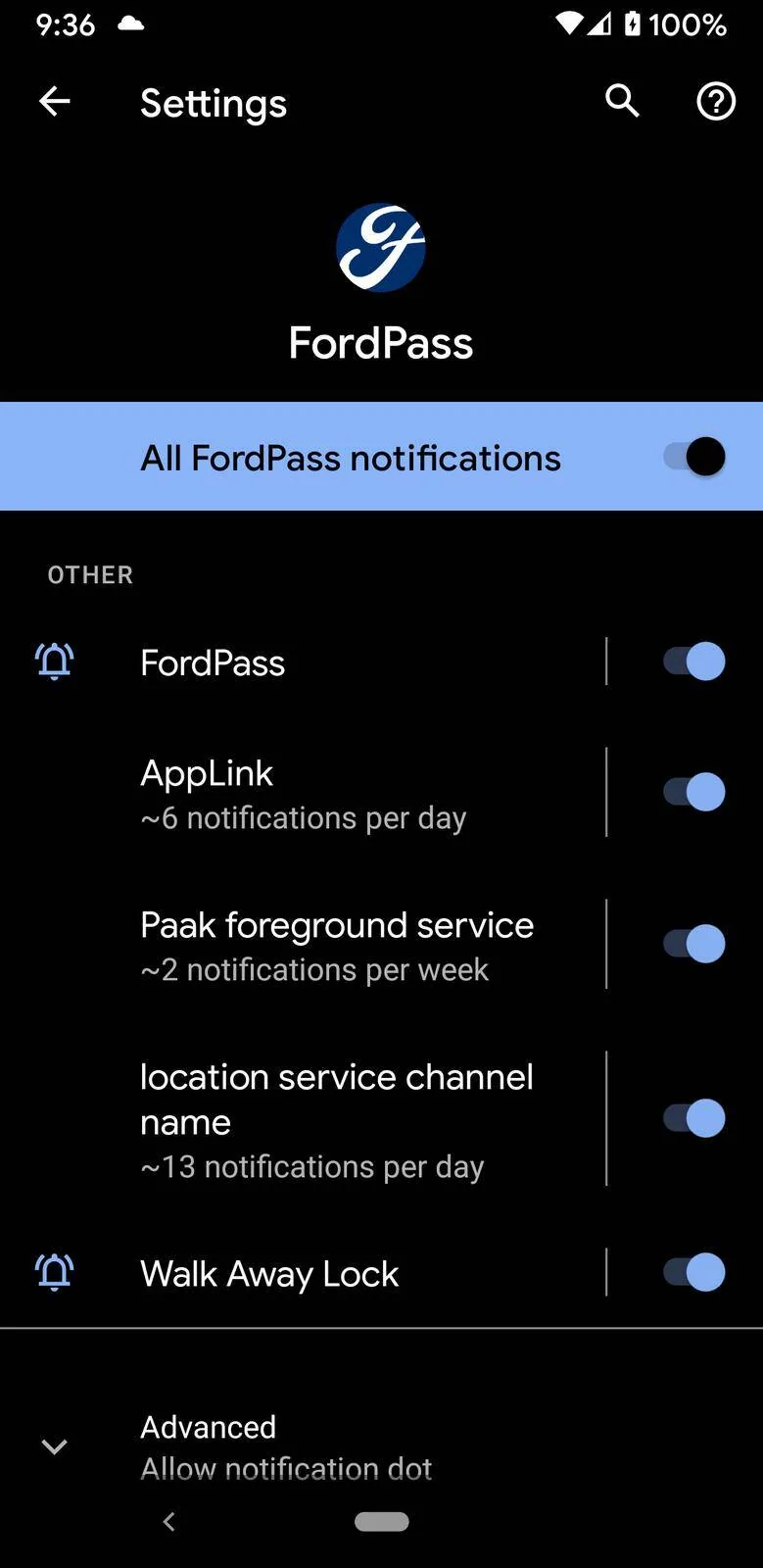

Walk away notification works fine on our Google Pixel 4a phones.
Hmm. Yes it is on. I've turned it off and back on just now in case that busts it loose.
