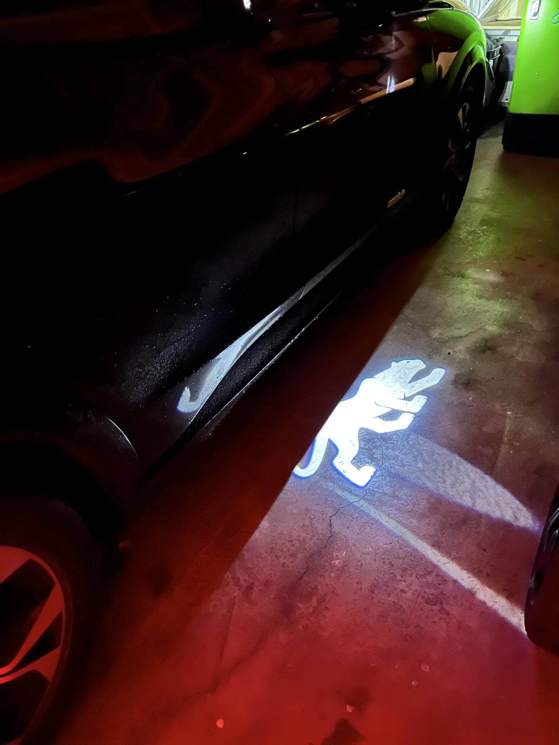

Yeah, but that was probably a vendor mixup at the light factory. The SR and ER batteries aren't a form/fit/functional replacement and couldn't accidently be used without notice.
Dunno. People make mistakes.
Just saying it’s possible.
More likely? Dealer #2 is wrong. But it should be fairly easy for a service department to confirm.
OP didn’t even specify the source from “dealer 2.” Was this a salesperson, tech or service manager?
