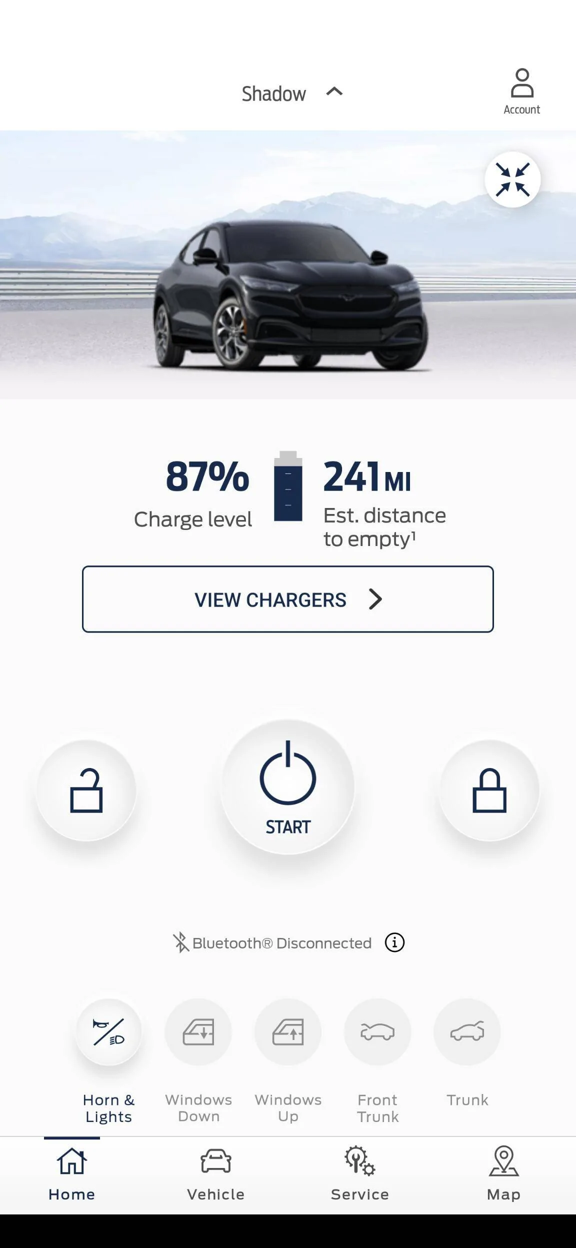

I'm in Orange County with an ER as well and showing that range at 87% so yeah I would say maybe the wrong car got delivered.
The VIN number would help immensely.
Ford Mustang Mach-E Ordered Extended Range Battery, Got the Standard Screenshot_20221230-114351

240 miles of range during winter on a full charge means it is impossible.
240 was the absolute highest. I didn't make that clear. Range 212 to 225 average. We will see. I'm educating myself more on this. Just say, my first all electric car I didn't have this issue.

What specific version of the Premium do you have? AWD or RWD? Posting your VIN would really help. Also, if you haven't reset Trip 1 or Trip 2, knowing how many miles you have, and the miles per kWh they report would be useful, too.
I'm in Northern California with a Premium RWD and I'm getting between 220 and 232 at 100% right now.
