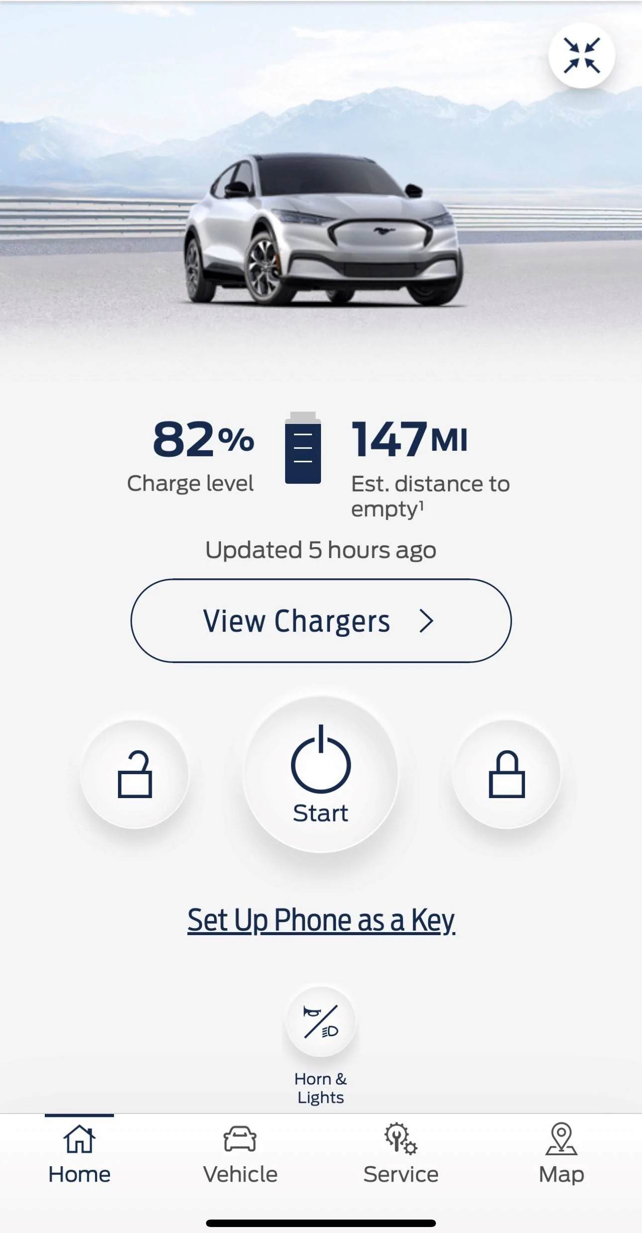

All kidding aside... Here is a current screen shot of my 2021 Premium AWD with the extended range battery.
Ford Mustang Mach-E Ordered Extended Range Battery, Got the Standard PIC
Now my battery capacity is 88 kwh vs the 91 kwh battery capacity you have (Ford increased the capacity for the 2022 model). I know I have the extended range battery because I have seen more than 70 kwh go into the battery when charged from a low state of charge. If you do the math, my 100% charge would show 180 mile range even though Ford's ideal "published" range estimate is 270 miles for my car. Unfortunately there are just so many variables that affect range like outside temps, driving style, driving history (sometimes needs to be reset), etc. that will change the estimated range that you see. As time goes on you will see that the display is not always correct and you will learn to adapt.
You are still welcome to spin your wheels with your dealer, but you are going to end up with the same battery you have in your car currently. It is just up to you as to how much time you want to spend going around on the dealer misinformation merry go round.

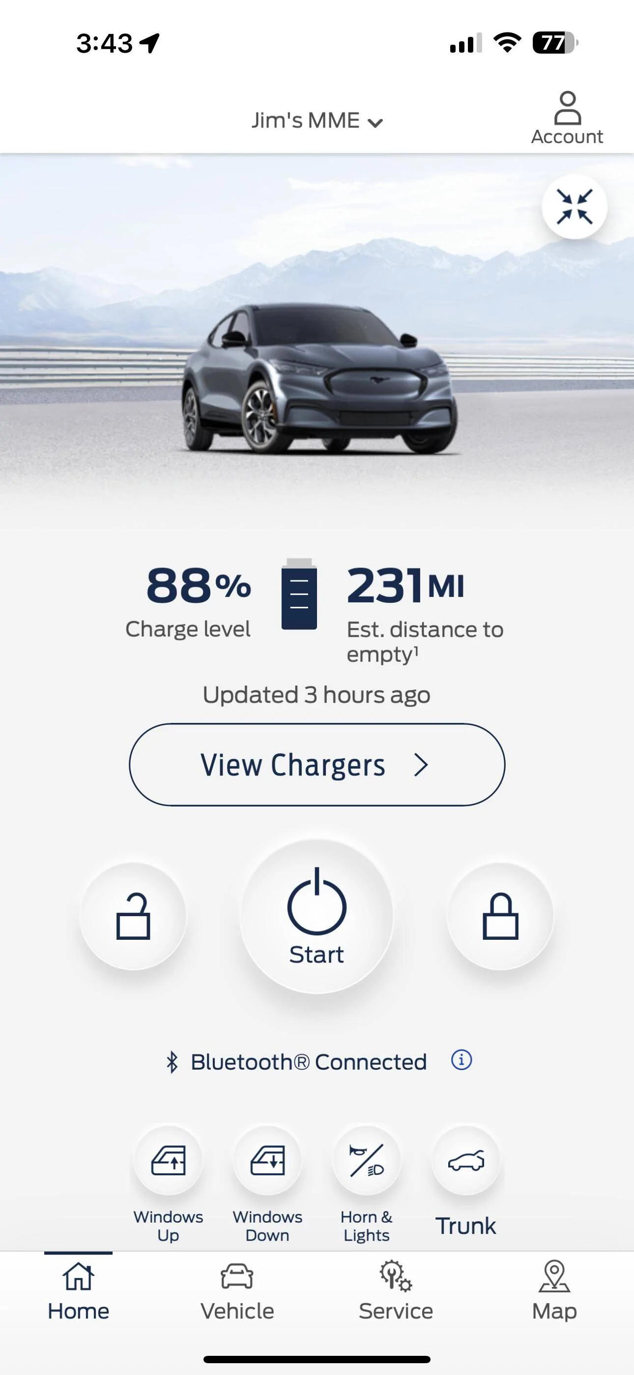

Ok, I’ll add a bit of excitement to the discussion. I have a 2021 Premium 4X (eAWD ER). It’s recently been charging to 90% and around 240 miles since the latest update Ford did to the GOM. Here’s what I’m at right now. Remember, 2021s only have 88 KWH usable capacity, not the 91 KWH usable capacity of later model years. We have the same batteries - Ford just hasn’t unlocked our buffer yet. That’s coming with the frunk release ?
