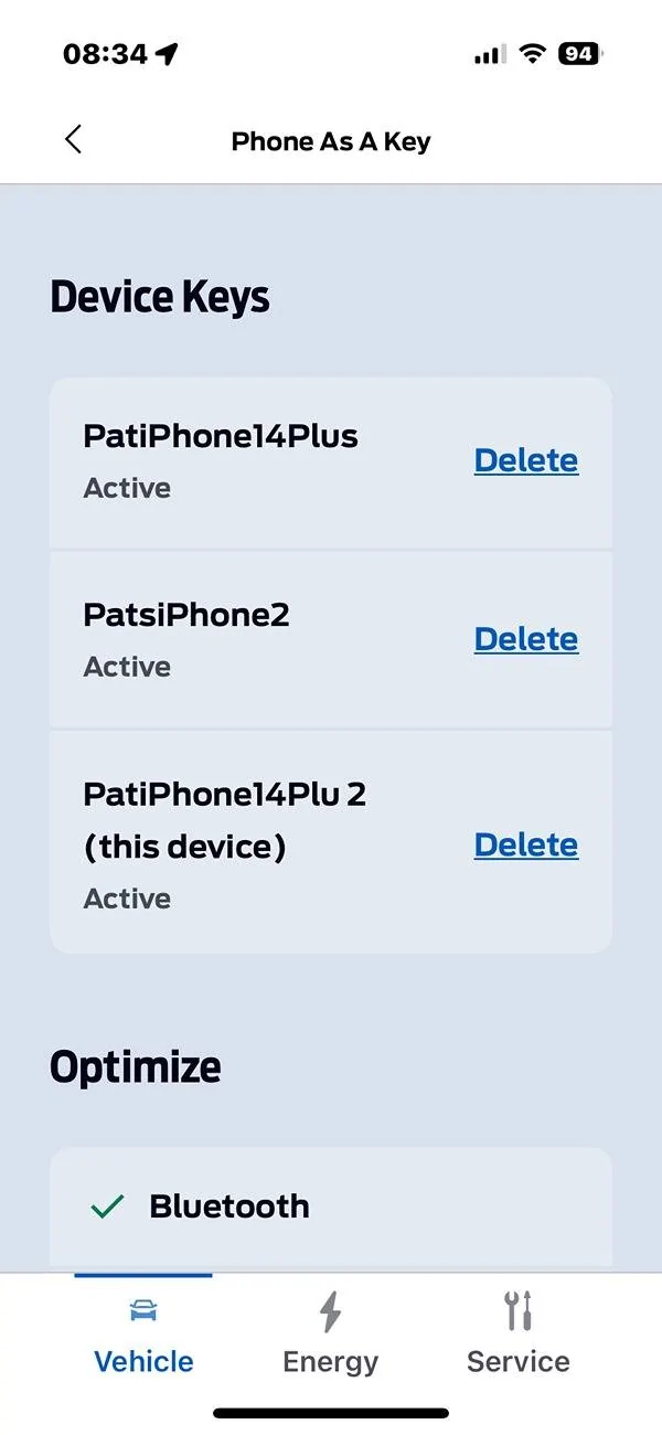

After rebooting the phone (shut down and restart), check for app updates.
Then check the Ford Pass app and check if your phone is listed on the PAAK.

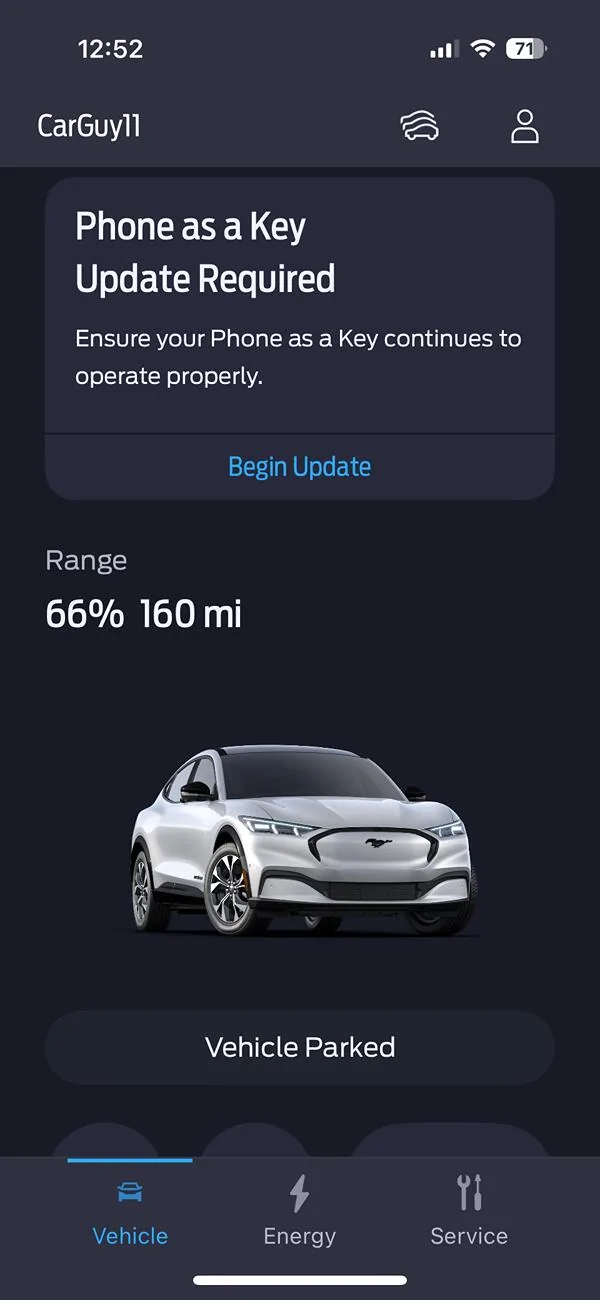

Some users have been getting a warning message about needing to refresh their PAAK keys, perhaps it's related to that (and not everyone got the message). I would make sure you're updated to the latest version of FordPass on your phone, and if it still doesn't work, you may need to re-create your phone keys?
