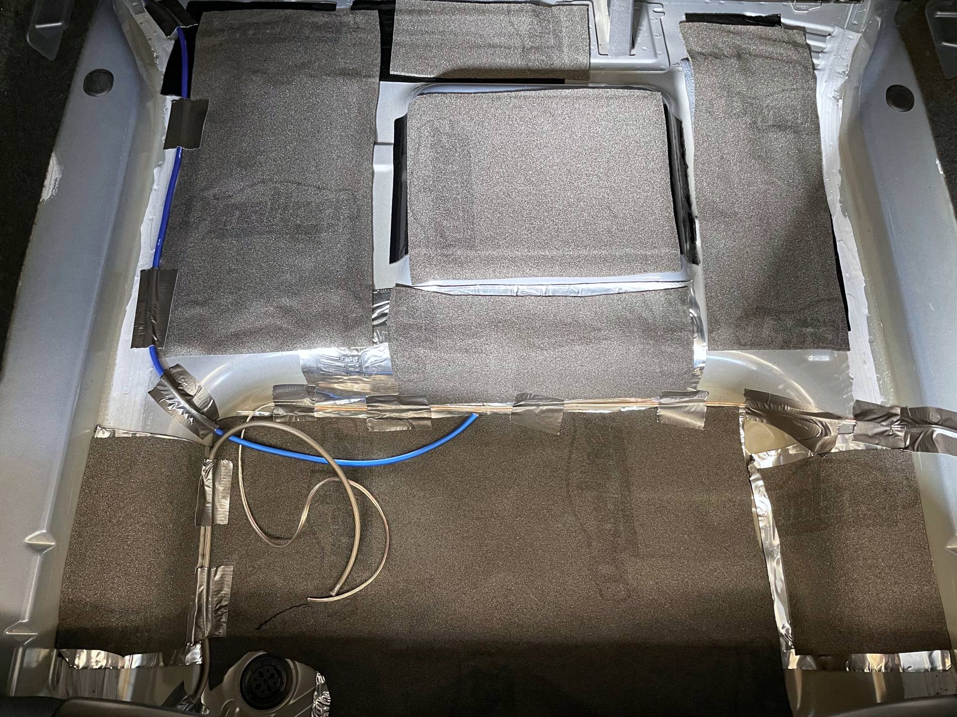

Yes you are right about the tires. While they aren't the noisiest tires out there, they aren't the quietest either. The issue with any XL (extra load range) tire is they are noisier than standard tires because of how they are made with the extra stiff reinforcement. Manufactures are aware of this and in many of the XL range tires, they have added foam to the inside of the tire to quite them down. Many Tesla's have tires with sound deadening like Continental Conti-Silent and Michelin Acoustic tires. The only Mach-E to have acoustically quieter tires is the GT/PE which have Pirelli P-Zero Elect PNCS (Pirelli Noise Cancelling System) tires. When I changed out the tires on my Mach-E for larger ones I looked for this but Michelin did not have an acoustic tire in the size I wanted.
Since most the noise does come from the tires, it would be a good idea to try to get quieter tires if you are after less road noise. Next could sound deaden all four wheel wells but the rear is more important since the front wheel wheels are really not part of the interior of the car like the rears are. Also deadening the doors is good too a lot of the road noise comes through those doors. Again, the Mach-E is very well insulated from noise as it is so quieter tires would probably be your best bet.
I use products like Dynamat (rubber butyl type material) that is sticky on one side and has foil on the other. This will deaden all metal panels to a low thud when tapped and is a good insulator of temperature too. Then on top of that I apply Dynaliner (1/4" closed cell foam) to reduce certain frequencies and it will make a door interior or wheel well very dead sounding (no echo). There are many manufactures that make similar products so not like you need to get either of these two.
I normally take photos while I am deadening a car but actually took very few of the Mach-E. Kind of done taking photos as I work now. In the first photo below is the cargo area. After removing the hard carpet liner, it was all bare metal. I applied Dynamat on most of the metal areas then on top of it, the Dynaliner foam. I usually apply slightly larger pieces of the foam so that is why you don't really see the Dynamat material because it is underneath. I would normally do this on the floor and roof of the car but it is not necessary on the Mach-E (unless you don't have a glass roof). Did the same thing in the rear quarter panels and all four doors. The second photo shows the full hard plastic window regulator that does a decent job of sealing out noise from the outer door skin. I still took it off and lined the entire inner side of the outer door skin.
