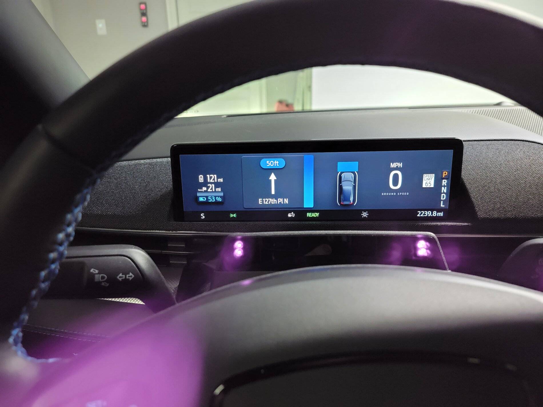

I get thats what it probably should be going off for. But that's not the case, at least in my car.
Sitting in my garage, it still randomly flashes. I'm not passing any intersections, no info on the main screen to look over at. Just random. It doesn't happen as much sitting in one spot. It took a few minutes for it to happen but every few minutes, it does flash up for me. I just went out right now to take this pic.
Take a picture of the screen next to it. The large display.

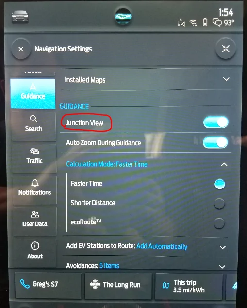

It isn't functioning correctly. Should only appear when using Nav. It is part of the JunctionView feature. Many users are hoping it gets corrected with one of the upcoming OTAs.

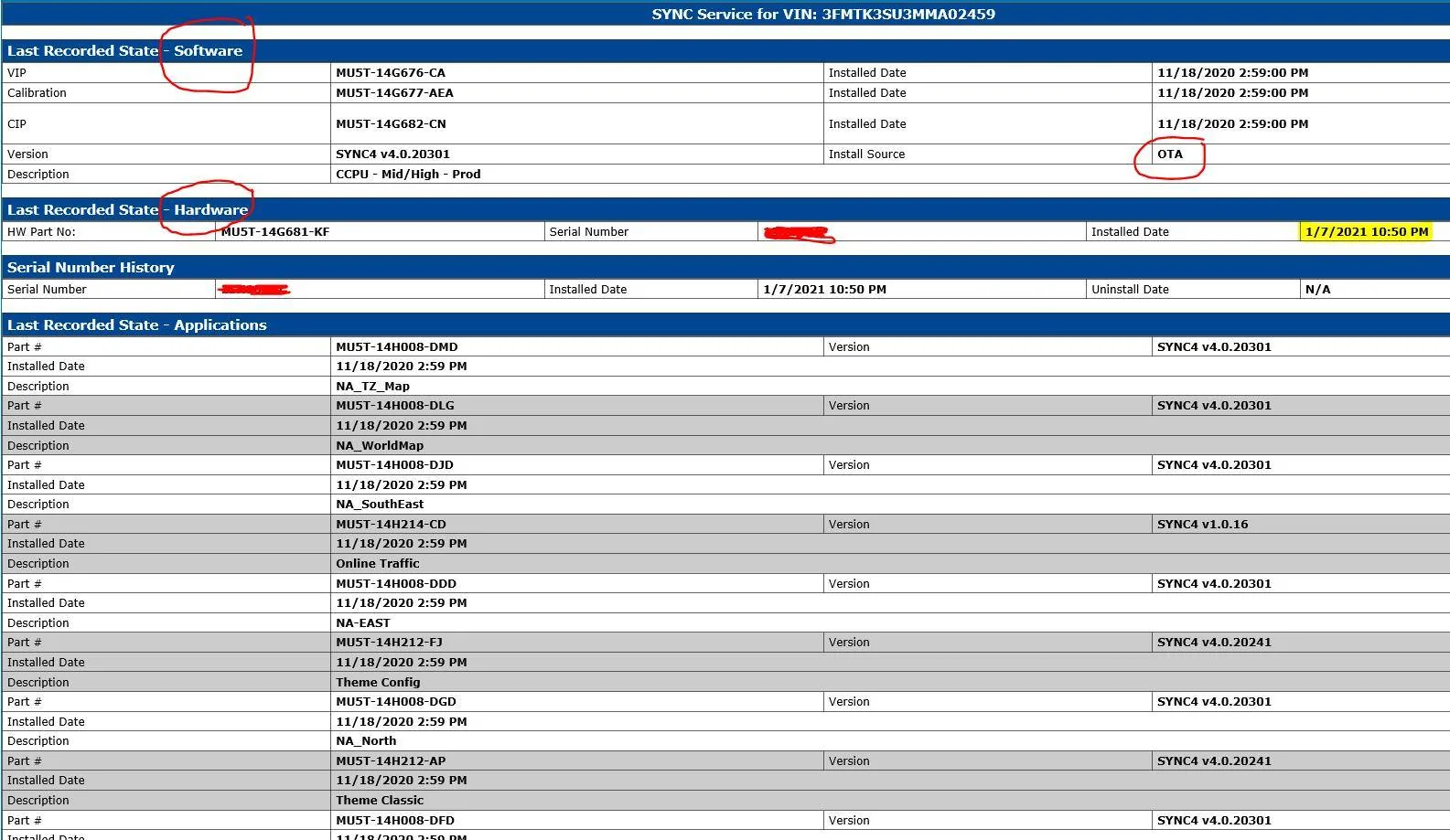

Here is a screen shot from the SYNC software report for my car.
For the Software part.....it used to say EOL (End of Line). It recently changed to OTA. I last looked at this screen about 7 or 10 days ago so it changed sometime since then.
Is anyone able to help me understand the difference between "Last Recorded State-Software" and "Last Recorded State-Hardware"?
My car was one of the pre-OKTB builds that then got parked for about a month until the OKTB certification and inspection process was cleared. Then it sat for a while longer, presumably to have whatever campaign performed related to the SYNC Hardware. Was released from the plant on Jan 21st. Every other pre-OKTB car that I have looked at....(maybe 5 or 6), have the same SYNC thing (hardware installation date in Jan just prior to being released from the plant)
Ford Mustang Mach-E Strange Blue bar while using NAV 1615563687239
