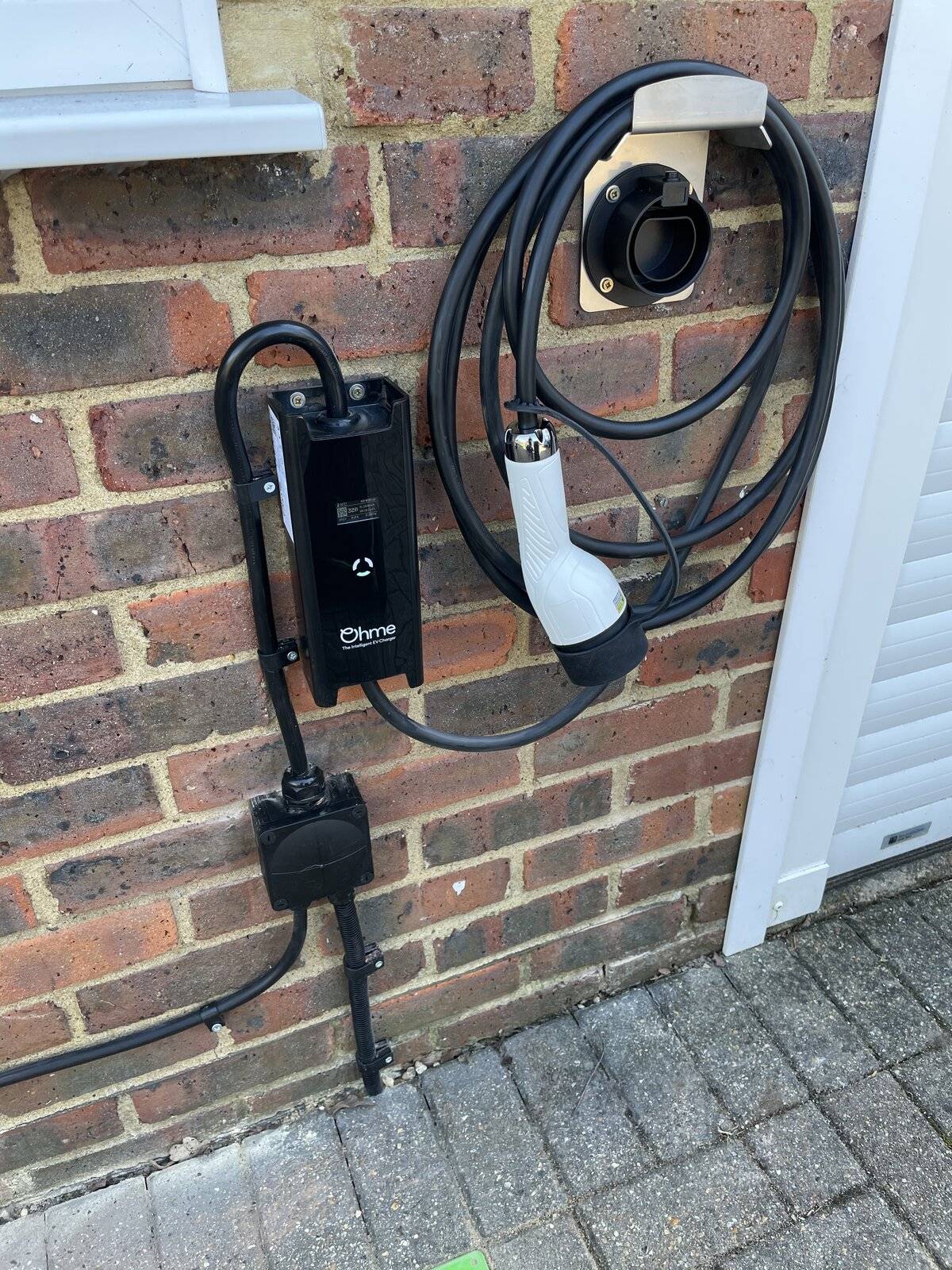

Mustang mache on order
I went with the Ohme charger as I will use the ability to charge at low electricity rates with Octopus

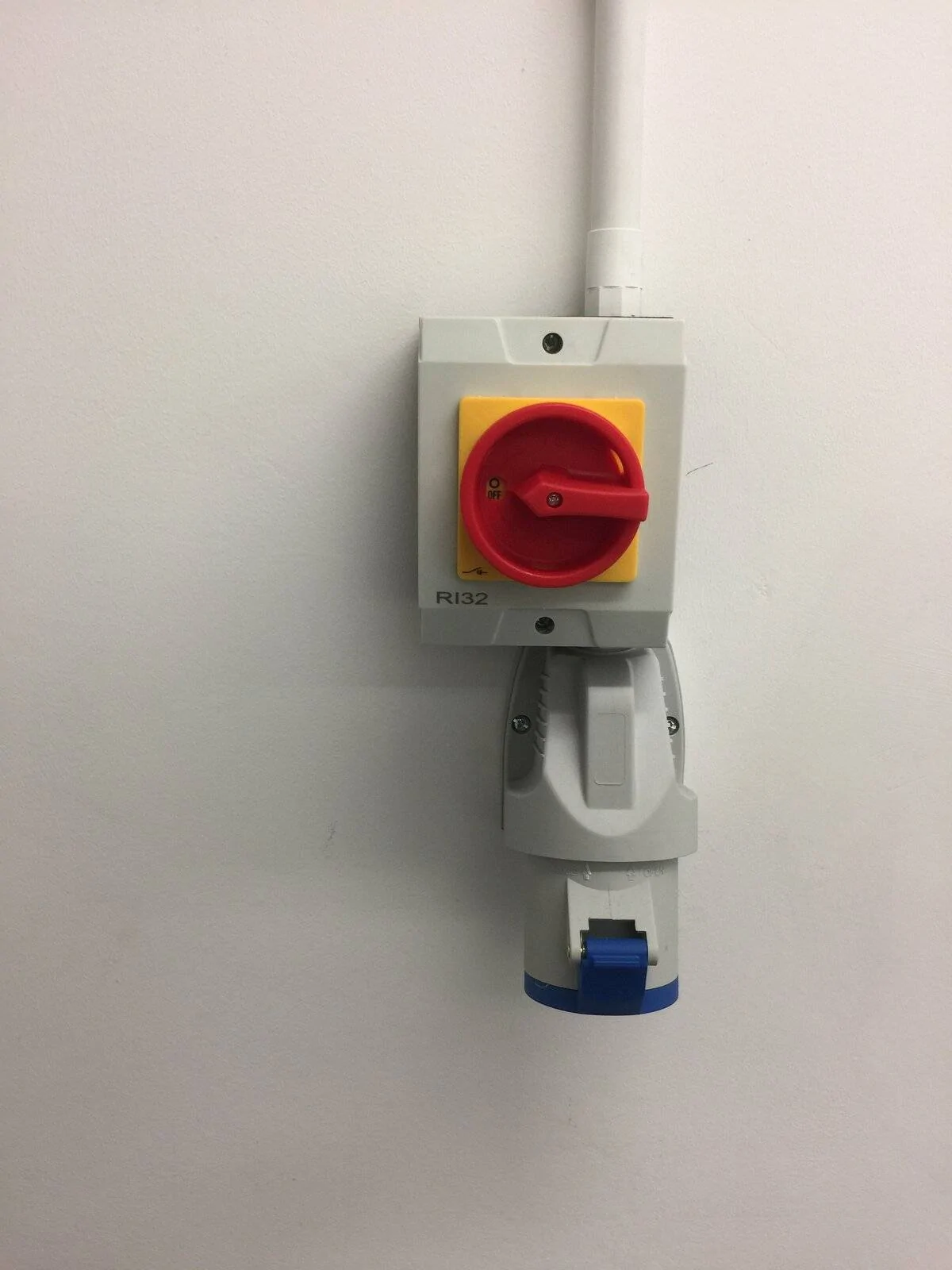

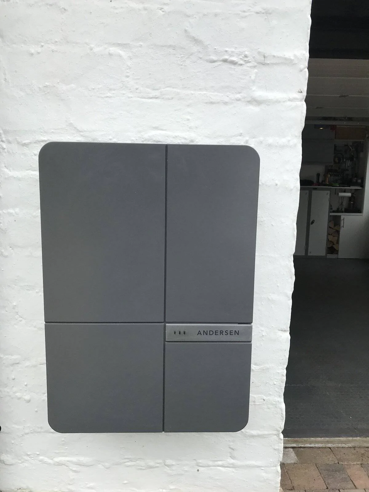

Am I the only one on here that has installed a 32amp commando socket with the intention to use the Ford Variopower charger that is supplied with the car as my home charging option.
Certainly not alone. I had installed a commando outlet installed in my garage to charge in the winter and an Anderson unit outside where the car will be most of the year. We can also charge another car as the Anderson unit has a load monitoring and limiting facility.
We fortunately have a TT earth system so did not need any additional earth rod. Although the Anderson does have integral PEN fault protection in any event, as do zappi and others now.
