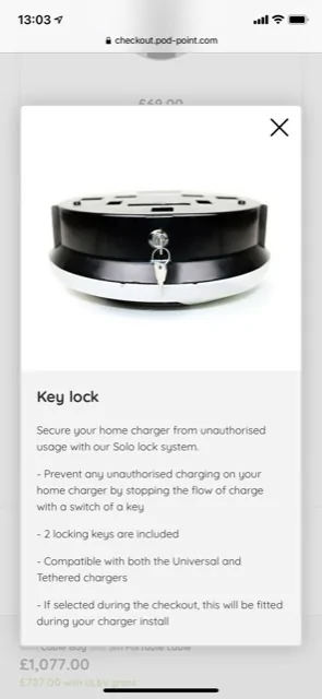

I thought you could get a lock for the podpoint, in accessories,to stop people from using it while your away.

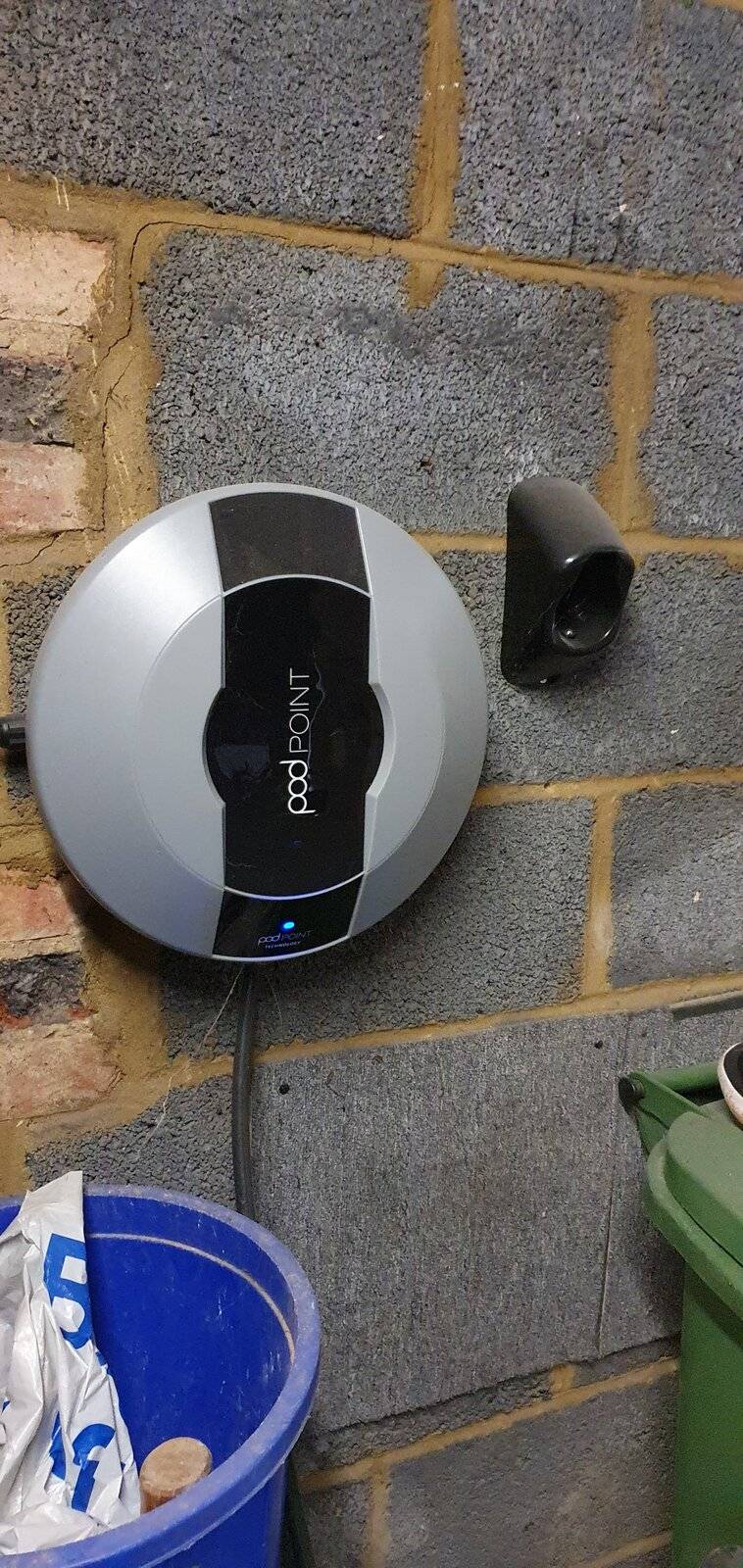

I thought the varipower plug is a regular granny charger? They take ages to charge, but if you have the time then why not? I've personally never used my granny charger as I've never had the need, but I certainly would take it on a long journey in case I couldn't get to a proper charger once at my destination.
Oh and this is my popping, with the ability to wrap the cable round and attach the plug to the wall for safe keeping, but I'm too lazy so it trails on the floor and is propped onto a cardboard box. Looking forward to getting my mach-e as my charging point is right next to the front passenger side so I may even start storing the cable properly!

That's where I see it. Can pay as a optional extra.
