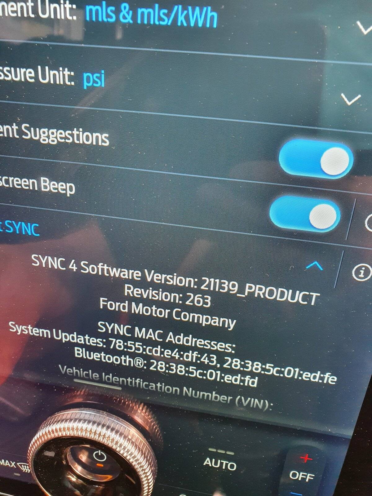

Interesting few days with mine. Firstly, got a successful update (no. 3) but apart from securialert hadn't noticed any changes.
Took youngest daughter to a wedding reception Friday night and all of a sudden got a message on drivers display saying that one pedal mode had been deactivated and to use foot brake. The ? icon also illuminated on the drivers display information bar. The car also went into limp mode. Managed to pull over and then got another message saying service vehicle soon. I have only done 2300 miles. I turned the car off and then on again and message went and car came out of limp mode but ? was still showing. Stopped off to do some ?, switched off and left/locked car. When I returned and started car the ? icon had gone.
Took car to hospital yesterday and they said no faults were showing but there was a TSB that needed to be done. All seems good now.

@portlandg - sorry to hear your car ended up in the hospital. Oddly enough mine’s there as well at the moment having diagnostics done on the SYNC screen.
What that has given me though is the unique situation of having a different model of Mach-E to play with (an AWD ER thanks to Hannah)
So while the RWD ER models seem to have Power-Up 1.4.0 with SecuriAlert etc, I’m finding the AWD ER model doesn’t have that yet. Oddly they show the same identical software versions on SYNC though.
Weird isn’t it.

I have a SR RWD, has the same software versions as Portland but no Power-Up or SecuriAlert. Noticed my Sat Nav is not the most recent version either but every time i check (which is every time I get in the car!) it still says I'm up to date....
Well that just adds to the weirdness ?
Is there anyone with a car that isn’t a RWD ER that’s had an OTA - or is the RWD ER club an exclusive OTA club as well?
