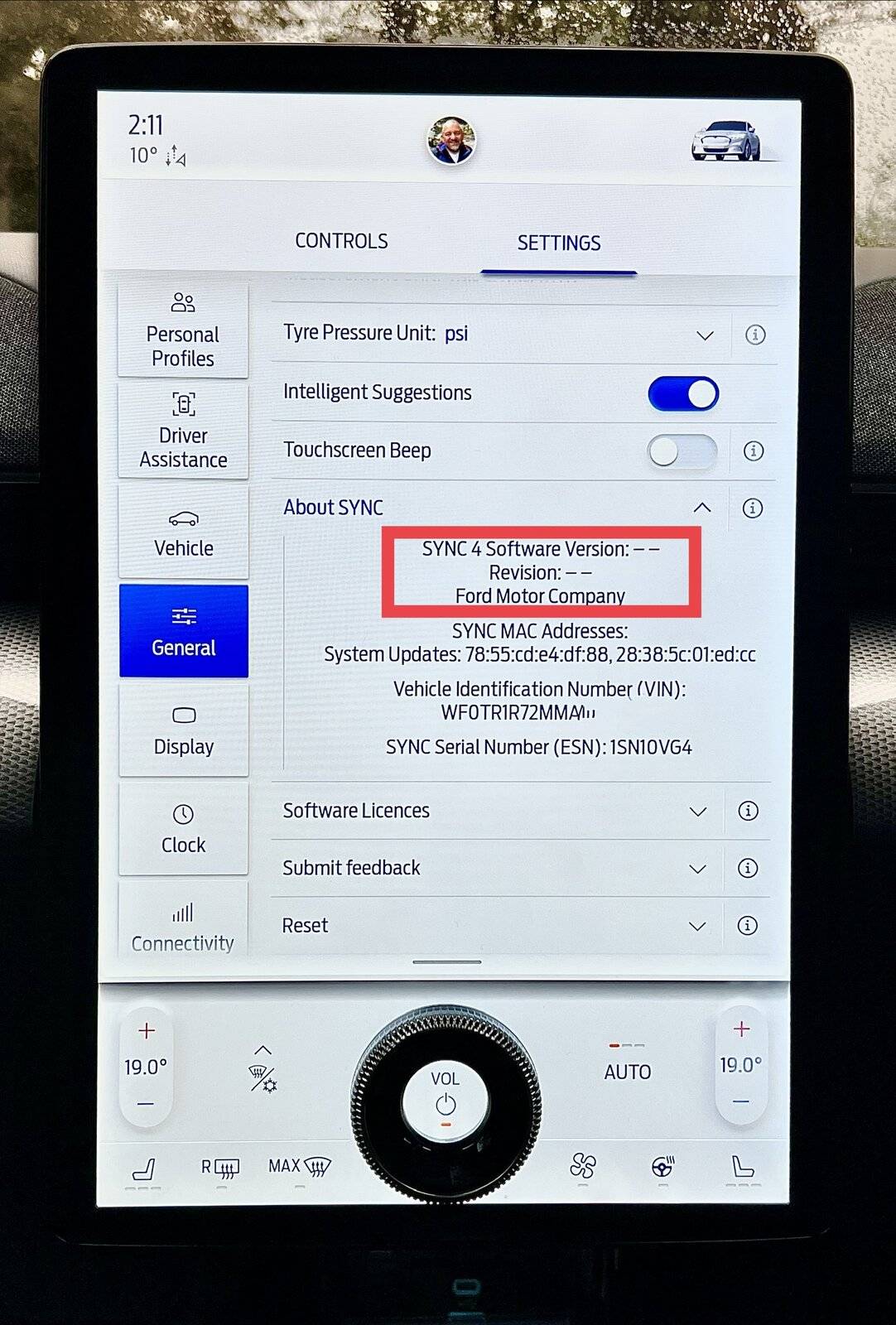

Well after reporting a 1.7.1 update (see yesterday’s screenshot) this morning I’m showing the default “Your system is up-to-date” rather 1.7.1
My automatic updates button has also now been disabled ?
I did a master reset via Sync just to give it a chance to bed in - and no change. Don’t seem to have any of the new 1.7.1 features either. #disappointed
How is everyone else’s update going?
My auto update button is also disabled. I thought that when this update has finished installing that the button would be again usable.
I wouldn’t have done a master reset in your case. There is evidence in the forum that 1.7.1 takes days to install properly after you are notified On sync. Only when you get the message In FordPass is it done.

Oh well - whoopsie!
I read the previous post where a Master Reset was suggested/recommended. So I went ahead and did it. Interestingly I have done Master Resets before, and one time it said it wouldn’t let me as an update was in progress. I didn’t get anything like that today when I did it so presumed it was ok. Seems there is some level of self protection in the system - hopefully I’ve not confused it too much.
Reassuringly it has just jumped back onto my Wi-Fi when I got home and has started downloading a load more data.
Also noticed that I no longer have a software version listed in my car (see screenshot)

Oh well - whoopsie!
yeah, there is a thread on that.
https://www.macheforum.com/site/threads/ota-1-7-1-stuck-anyone-else-have-issue-updating.10071/
I suggested a master reset after 1.7.1 is applied using FDRS not OTA. Should have been clearer…sorry
