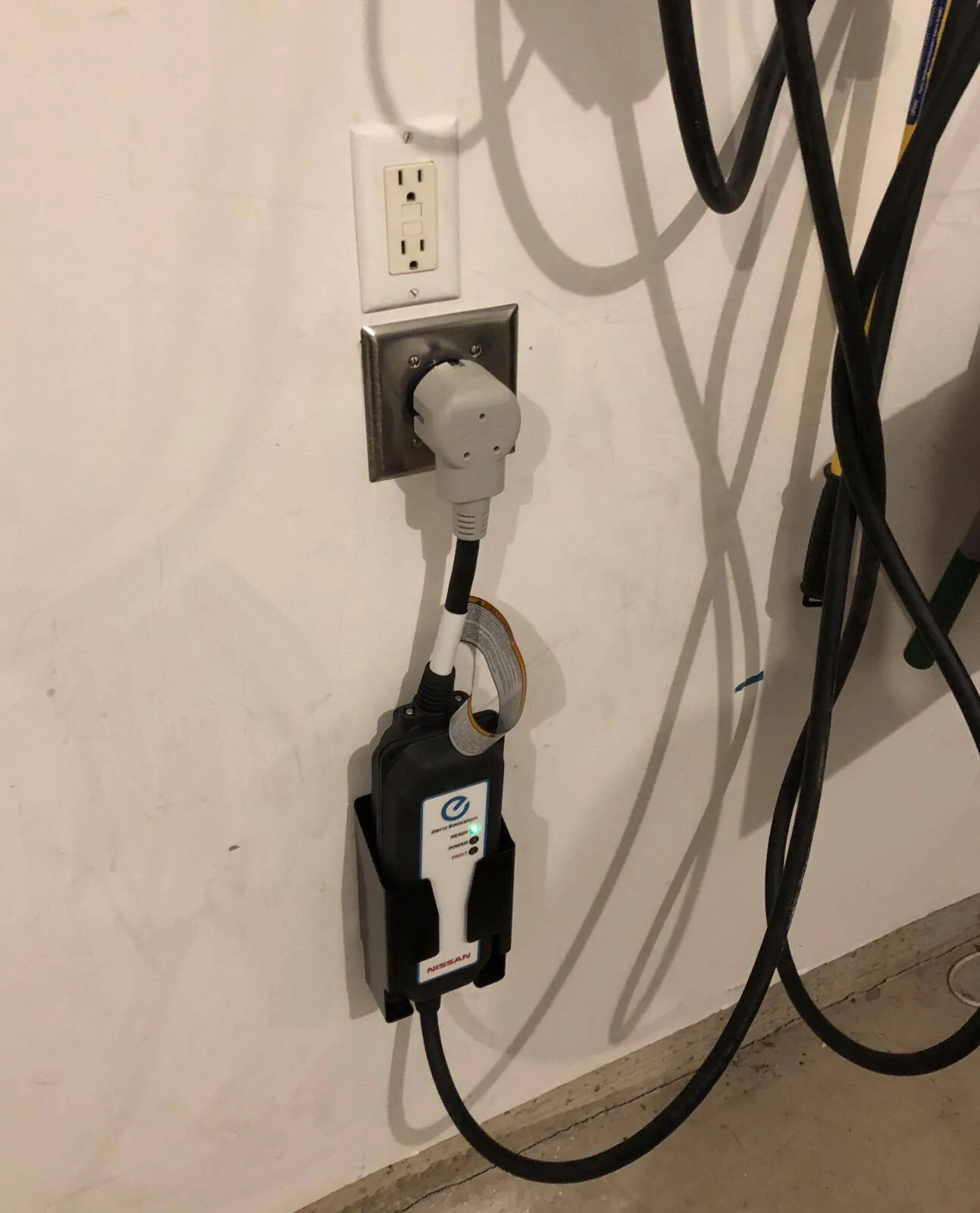

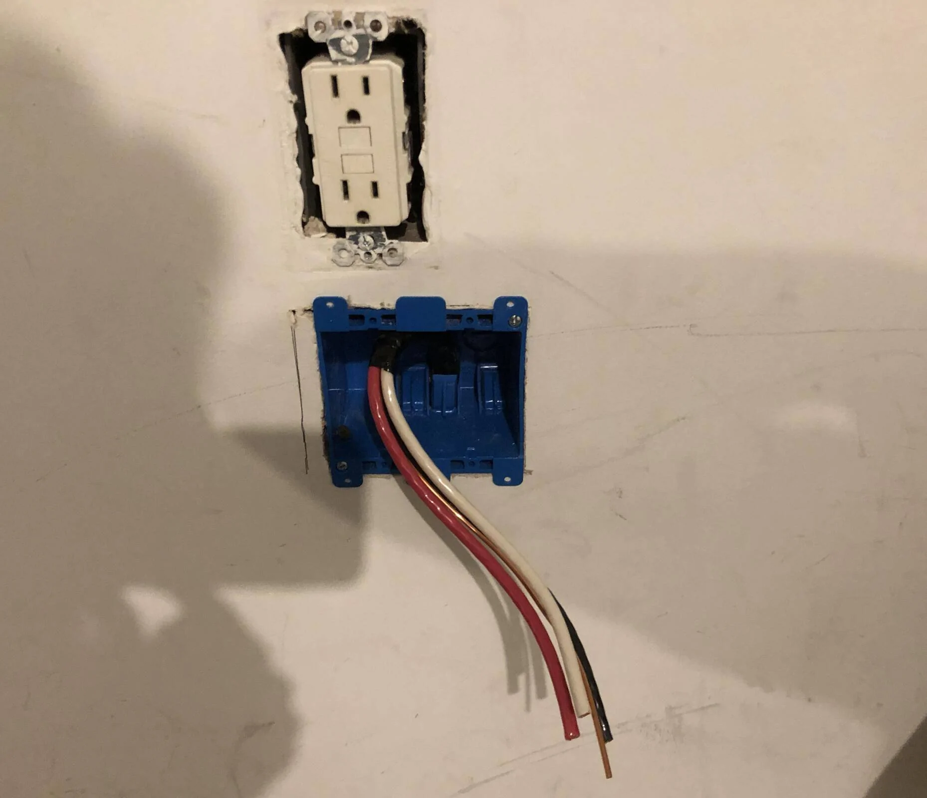

I installed a 60amp breaker for my NEMA 14-50 outside "RV" plug. I only use it for a 32 amp charger that I plug into it. I did 60 amps so I could upgrade later. Now I'm looking to share another charger with the electric dryer outlet.
I don't plan on buying a faster charger.

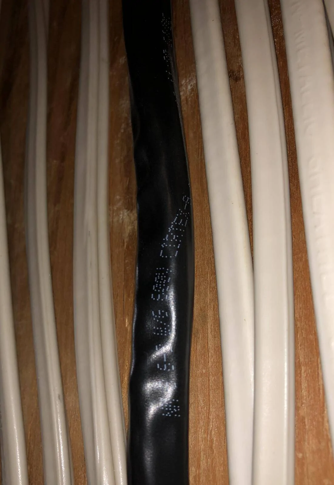

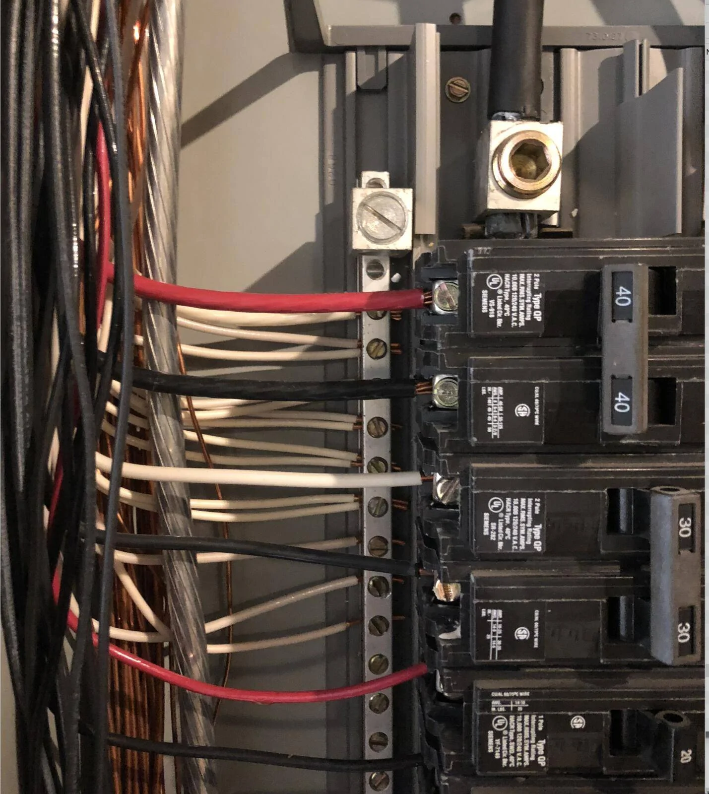

I installed a 40 AMP breaker with 6 AMP (NM-6-3) cable. I would have installed a 50 AMP breaker but my panel already was outfitted with an unused 40 AMP so I left it. Today I only use up to a 32 AMP charger so it's fine for tomorrow. I am not too concerned about being able to charge at 48 AMPS since the 32A charges fast enough. I doubt I would go through the expense and time to upgrade to 60 AMP cable with a 60 AMP breaker, plus the thickness of the cable is really hard to maneuver and pull. I want to say the raw parts costed less than $200 with the cable being the most expensive part of the job, which I don't suggest doing unless you know what you are doing. This should be it's own topic and not in this thread but just wanted to share my info.
