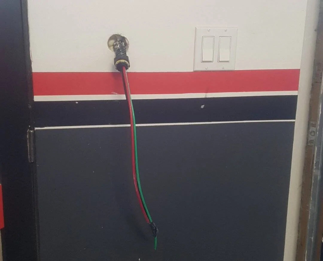

Actually what is required for the 48amp charger is 6/3 Gauge, you can put a 60amp breaker on that, especially If the run is complicated like mine. 4gauge is very hard to pass in the ceiling especially if your beams are closed off. If your panel is in your garage than go ahead and pass the 4 gauge. In my case my charger didn't need a neutral, just 2 hots and ground. Not sure about the Ford charger. I forgot to mention, the charger being a 48 amp has to be hardwired.
Your 3 wire charger probably has a 6-50 plug on it instead of 14-50
