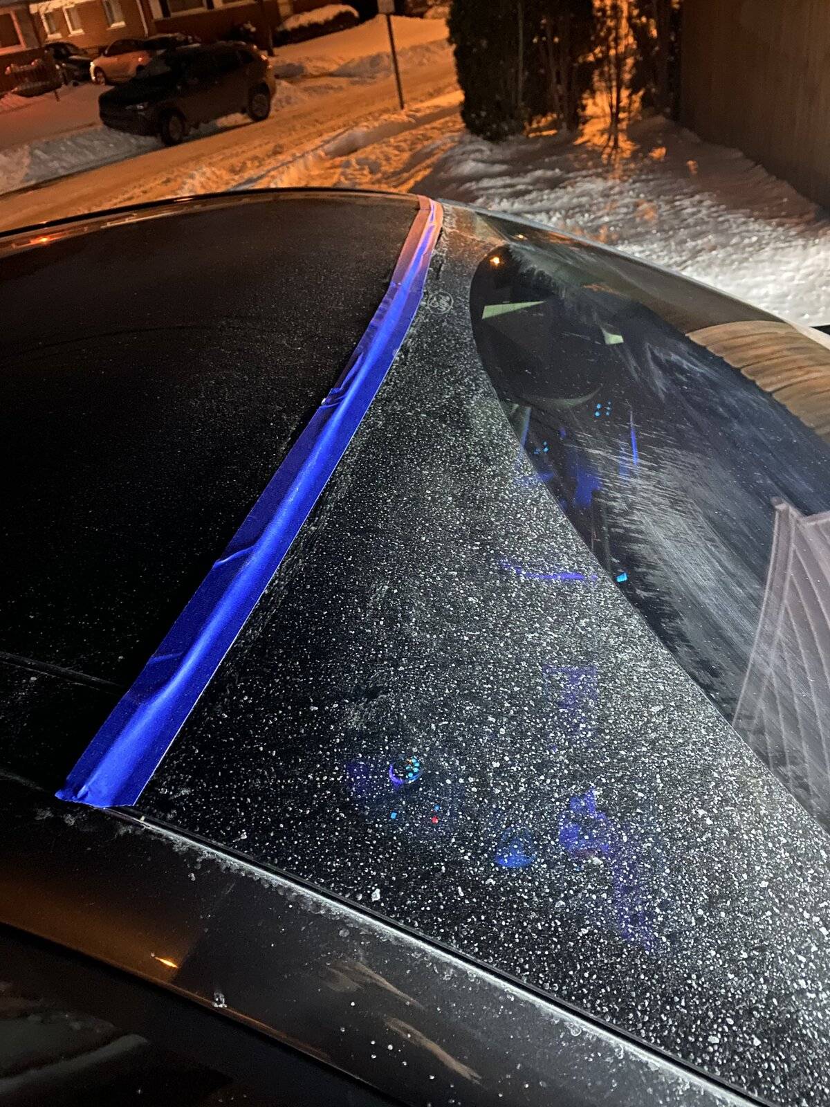

*UPDATE*
I just went for a drive after putting painters tape over the divide and the noise was gone. Even took it to the highway and got up to 92, no noise. I am in contact with Ford’s friends and family customer service team so hopefully I will be able to find a solution and keep everyone posted

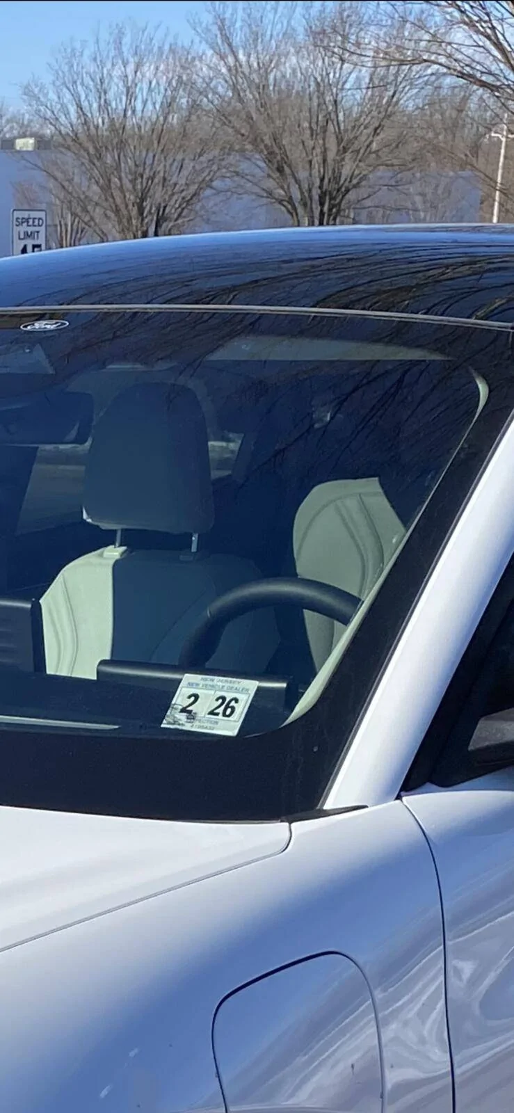

Test drove a premium this afternoon. Wind noise was noticeable on top part of front windshield. Based on some other reviews, I expected to be quieter. Glass roof was also higher than windshield. Hoping it's just some cars. My Acura certainly makes more noise from engine and road but wind noise was higher in the Mach E I drove.

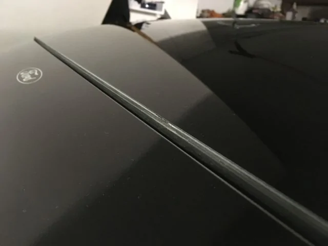

My roof definitely sits more than 3/16 above the windshield, especially in the middle of the car where the wind noise presents (the gap is not consistent across the car).
The noise is present at 40 mph and increases with speed, and I drive 90% expressway miles.
I’m determined to wait until it’s warmer to silicone it, and will likely use what a member of the forum recommended.

Further update: the strip of blue painters tape across the seam between the two pieces of glass definitely works.

*2nd UPDATE*
Just heard back from the dealership service supervisor. Their glass company came out and evaluated the roof and there no found assembly defects. I was told that wind noise is coming from the step up from the windshield to the roof as I suspected as the painters tape got rid of the sounds. The service supervisor said that a Ford field engineer will have to come out and evaluate the vehicle in person. He said they could manufacture a seal across it that would work and look a lot better than the tape, but because it is so new they want Ford to look at it first and determine if it will be a larger fix(recall type of situation I’d imagine)

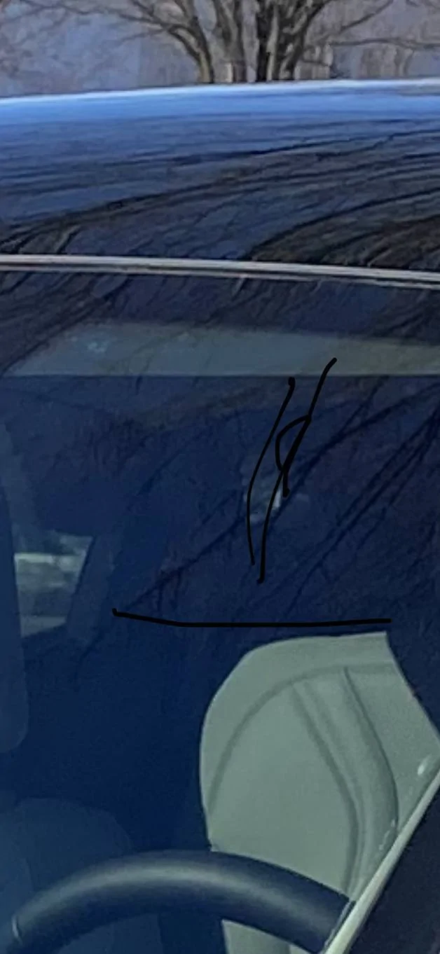

Test drove a Premium 4X today. Had it up to 70 specifically listening for wind noise and didn't hear anything noticeable. Glass roof was very slightly higher than windshield. It may not have been as high above the windshield as others but it's hard to tell from photos. Only had the car for about 45 minutes, so might not be a good test...
