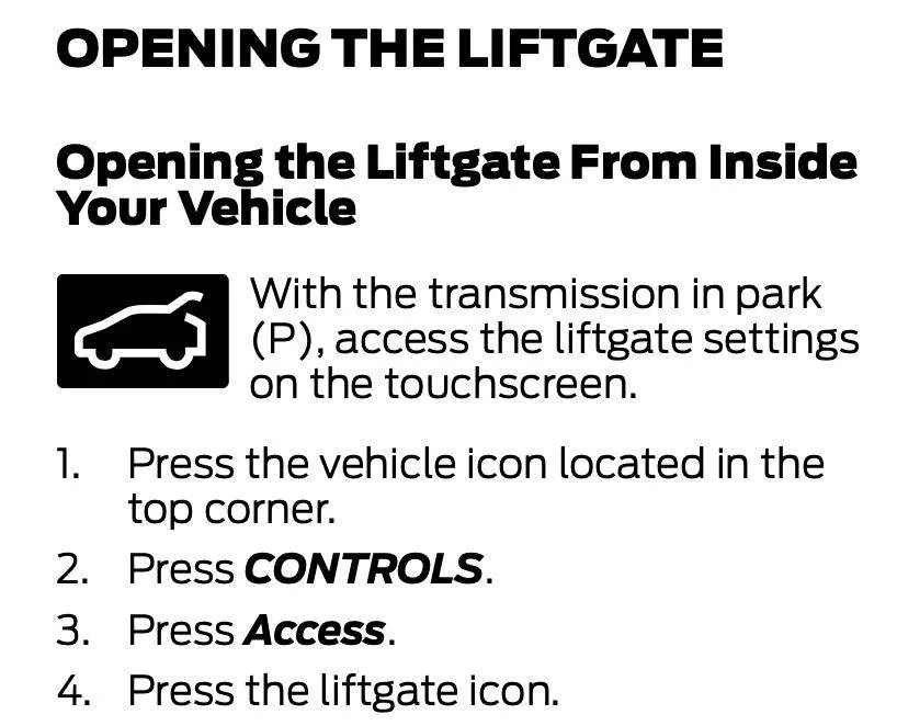

I *do* miss having the ability to easily open and close the back hatch with button. Like when the nice people deliver the groceries into the back and don't know how to open or close it. But, at least it's not the switch that was in my VW Tiguan that opened the back hatch, but didn't close it! I guess no switch (outside of the center screen) is better than a dedicated switch that could only open it. LOL
The best options are the center screen
Ford Mustang Mach-E Adding a Physical Interior Liftgate Power Switch Screen Shot 2021-06-29 at 12.08.06 PM
and the home page of your FordPass app.

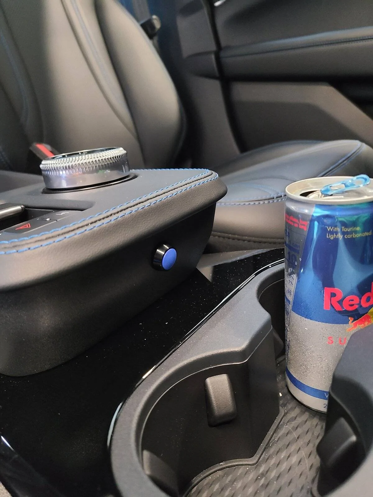

Thanks to the OP @markboris I completed this mod on our two FE's this am.
First one took a bit as I was learning and needed a third hand to hold the flashlight while installing the button, as I drilled the hole JUST a bit too high. All good, but the button doesn't sit 100% flush.
Second one took about 45 minutes and I didn't need the third hand as I drilled the hole in the proper spot. Button sits 100% flush.
My wife and I will enjoy having this feature back as we have had on our previous Lincoln's and Ford's.
Kudos Mark.
Jeff
Here's the pic of the Grabber Blue button:
