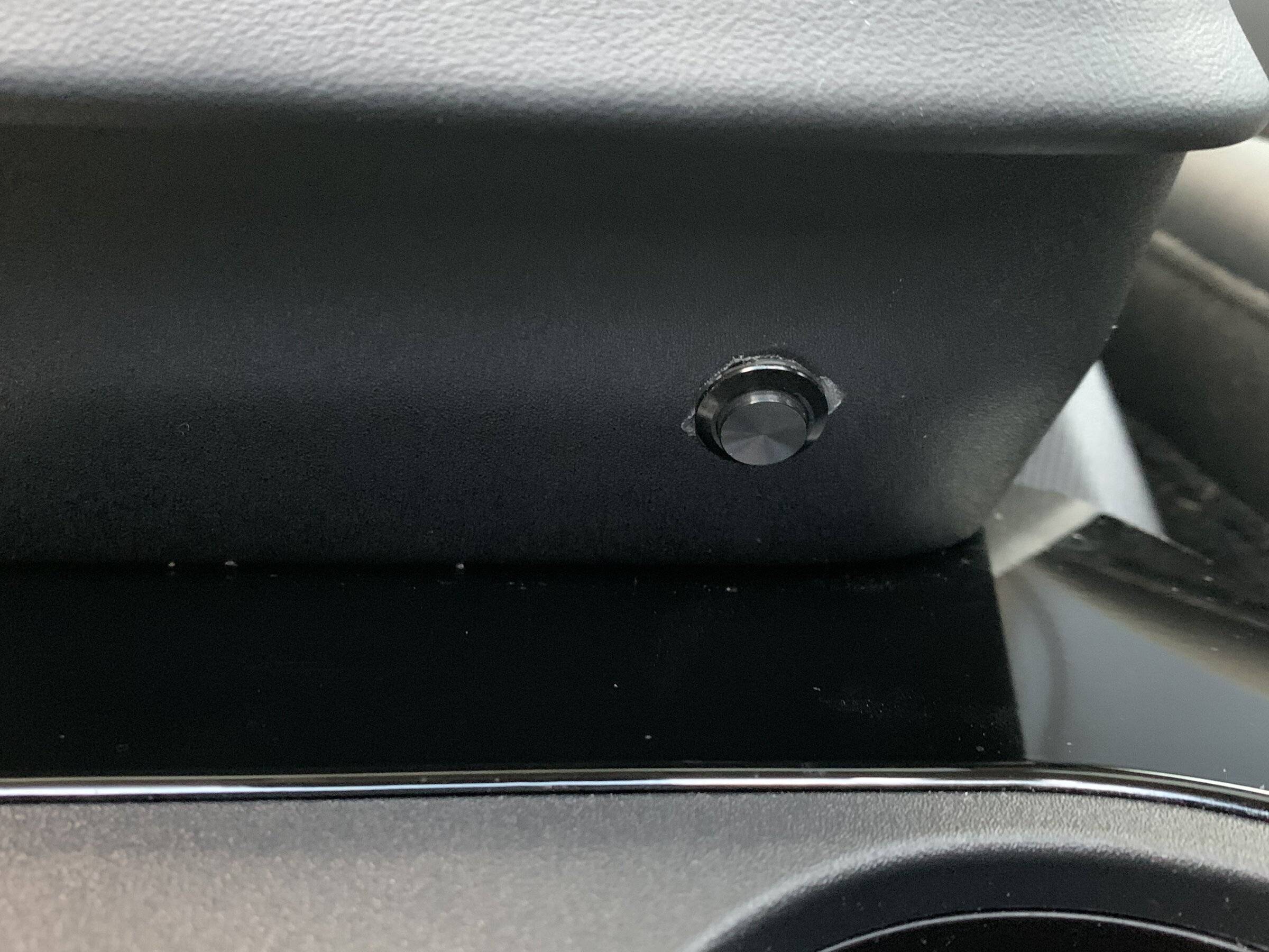

Mark — thanks so very much for your detailed write up & photos.
I will need to buy a grommet to cover the slight blowout that happened when I drilled the hole through the console for the switch. Aside from some difficulties in attaching a splice to the extremely thin brown wire, I accomplished this in about an hour and a half SOLELY DUE TO YOUR EXCELLENT guidance.
Very happy (and yet still can’t believe that this wasn’t standard equipment,)
again thanks & cheers.
