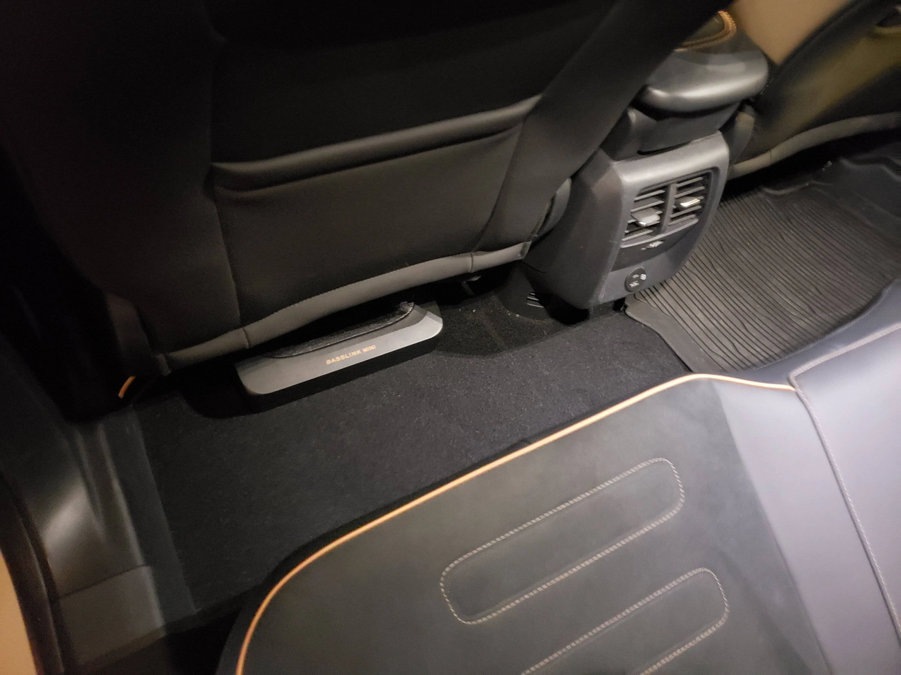

Yesterday I installed a Infinity Baselink mini under the driver seat. Sort of. I don't think this is a good permanent location, as people who sit there will have to put their feet on the subwoofer and I had to remove the floor mat. I am using Velcro (the hooks) to get it to stick to the carpet.
Ford Mustang Mach-E Adding a real subwoofer w/amp to your Mach-E 52596109103_d044f95133_o
It sounds great, and I especially like how it vibrates the seat. That is why I wanted to put it under the seat. Ideally I will find a way to mount it under the front of the seat, but I have not figured that out yet.
By the way, I was using the front speaker outputs to drive the subwoofer and there must be a serious low frequency cutoff happening to protect those speakers. So I ran a new wire from the subwoofer output and it sounds much better. I should have known better than to use the front speaker outputs, but in case someone else thinks to do the same thing, don't. Use the subwoofer output.

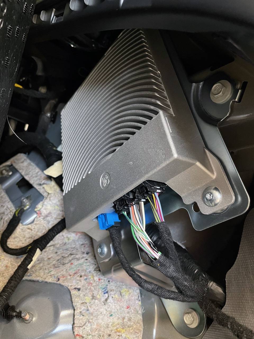

So the metal block next to the sub, with 2 harness connections (speaker wires of multiple colors) is not an amp?
Is there something incorrect with simply swapping the green Metra harness cables from the stock amp / subwoofer into my subwoofer instead ? I'm asking because I would either purchase or 3D print a harness and plug into the existing wiring This would make the install on my leased Mach E very reversible.
Once tapped, no matter the source wire, how did you lead the RCA into the sub? Mono or stereo? If mono how do you chose which of the 2?
Thanks again
Thanks again
This is the stock B&O amp above the OEM sub

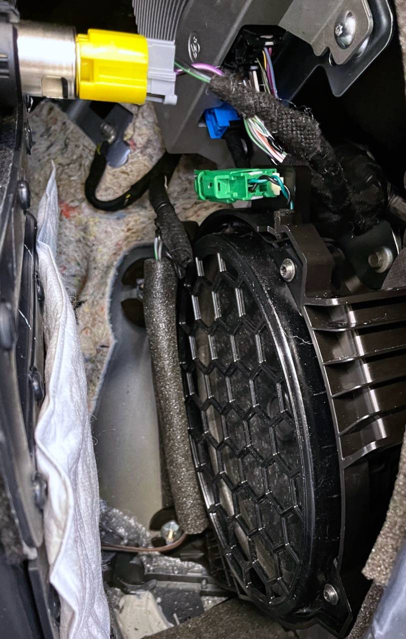

This is the OEM sub and the green connector at the top of the sub that I tapped into
Ford Mustang Mach-E Adding a real subwoofer w/amp to your Mach-E IMG_43061900

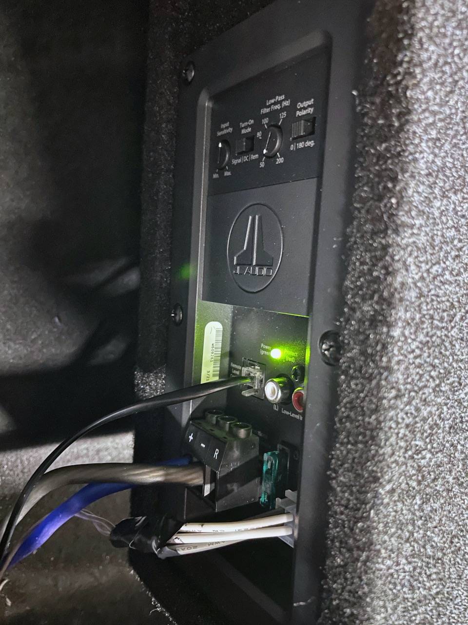

If you want to unplug the green connector at the sub and make your how harness to go from there to your amp that would work. You do not tap into or connect anything at the stock B&O amp. RCA inputs are for a low level signal. Since we are using the audio signal that is going into the OEM sub, that is a HIGH LEVEL signal so it does not use the low level RCA inputs of any amp.
If you are using the JL Audio sub amp, it has two sets of inputs. RCA low level (not used) and speaker wire/connector high level inputs (use). The OEM sub only has a mono audio input so on the JL Audio amp, connect it to either the left or right input.
You can see below on the JL Audio amp, there is a connector with 4 white wires. This is the high level audio input. I have two wires from the OEM sub going into just two wires of that connector.
Ford Mustang Mach-E Adding a real subwoofer w/amp to your Mach-E IMG_44231900
