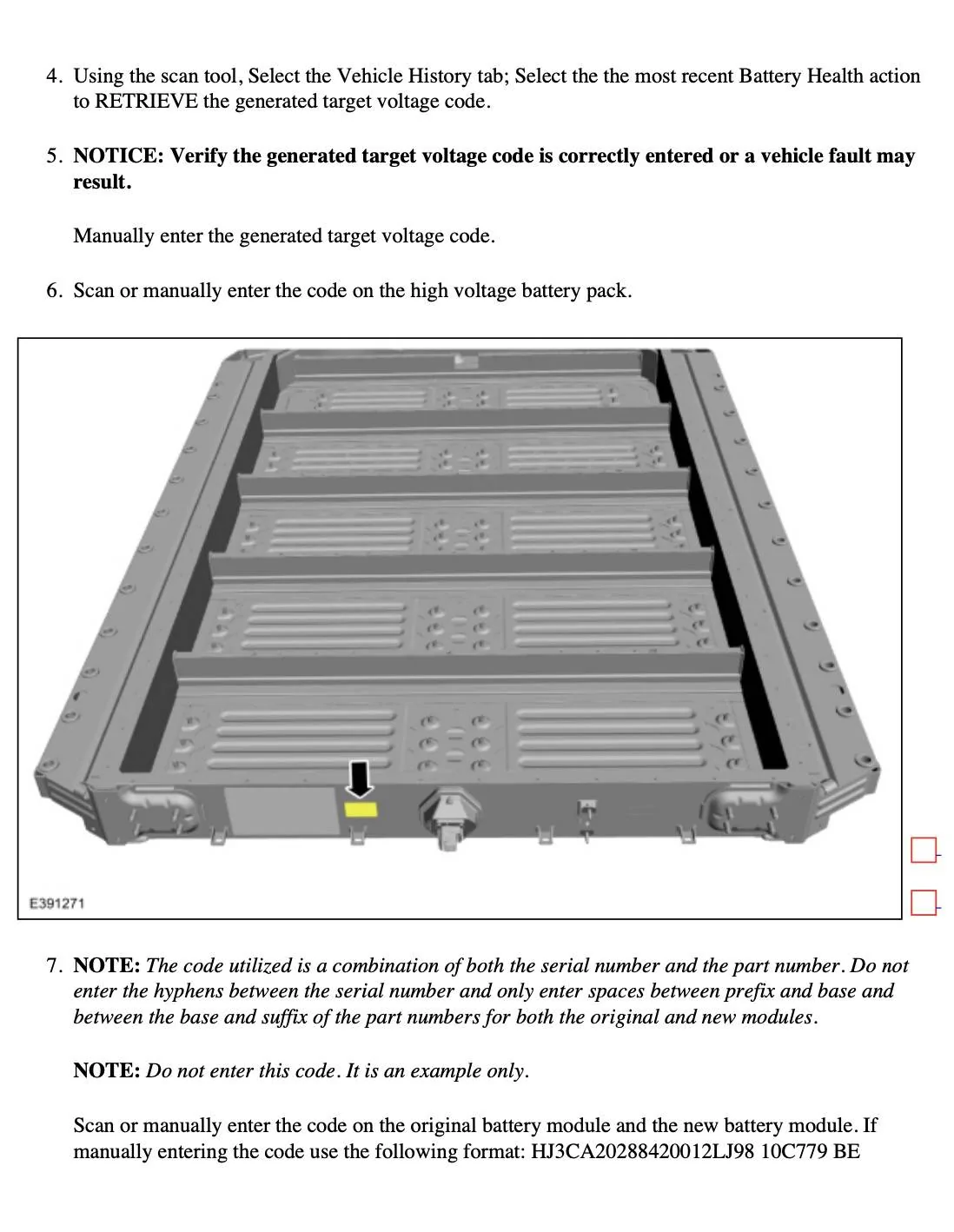

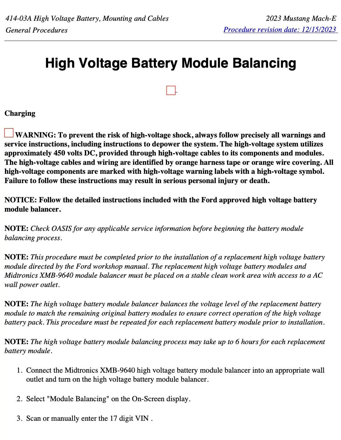

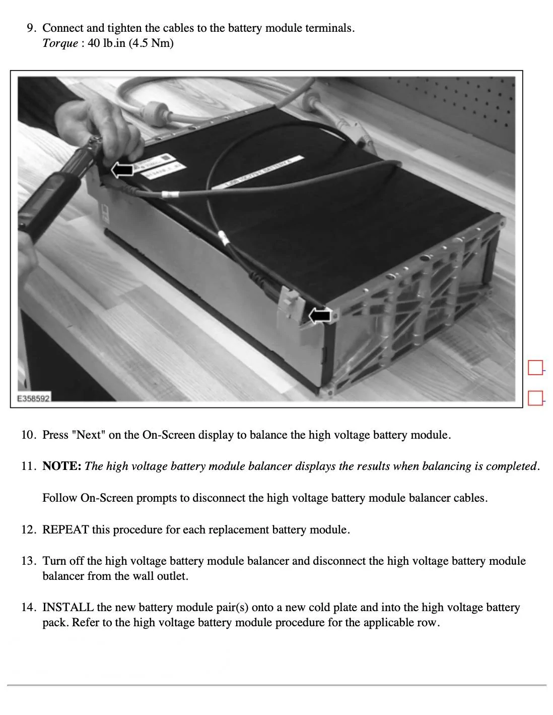

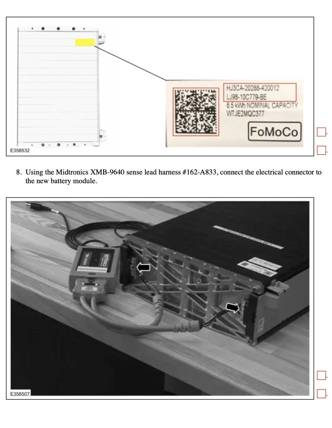

In case anyone is interested in the service procedure for using the battery balancer after replacing one of the battery modules. This is from the Mach-E repair manual.
Ford Mustang Mach-E Battery balancing service? Screenshot 2024-02-20 at 6.09.37 PM
Ford Mustang Mach-E Battery balancing service? Screenshot 2024-02-20 at 6.09.55 PM
Ford Mustang Mach-E Battery balancing service? Screenshot 2024-02-20 at 6.10.05 PM
Ford Mustang Mach-E Battery balancing service? Screenshot 2024-02-20 at 6.10.14 PM

That’s only used for battery cell module replacement. It involves dropping the pack, opening the battery, and hooking up to the new cell module on the bench. That is not a routine service, only when required by warranty to replace failed modules.
Again, this was a bogus service the dealer just made up to make more money by scamming customers. Your pack automatically balances itself, no action is required. It’s in the same category as a blinker fluid service.
