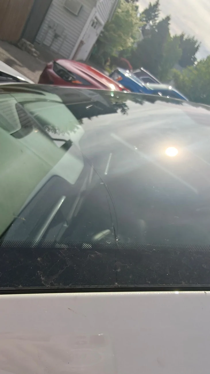

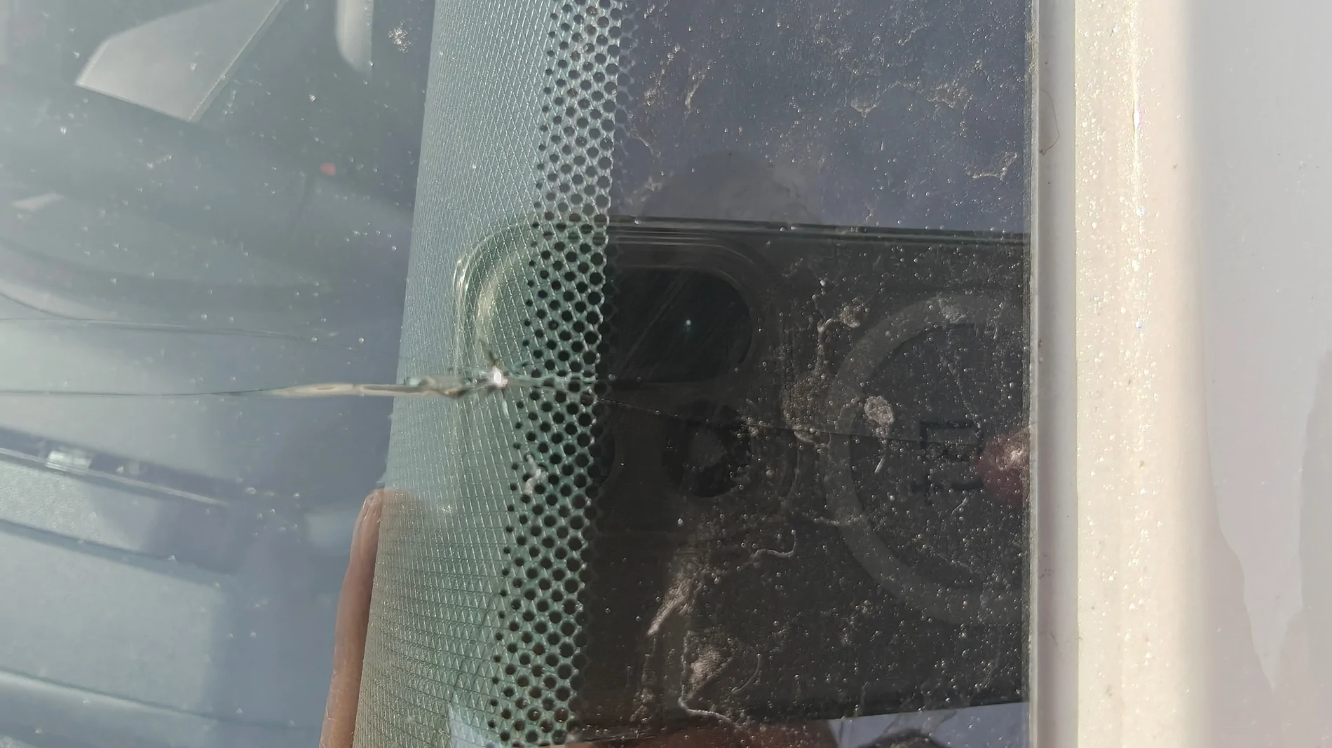

Had this happen this weekend, was a tiny chip smaller than the tip of my pinky and before I got home it was over a foot, now it's from the drives side to passenger side.
My question is with replacement, I am afraid that State Farm will use cheap glass that doesn't have it/uv coating and also cause issues with the censors.
Has anyone had an issues with generic glass, or with forcing insurance companies to use Ford windshields?

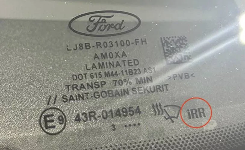

Every windshield has a UV coating. It is a question of whether your windshield came with an IR coating.

As far as I am aware mine has an IR film on the windshield.

It should have an IRR marking in the corner if it does:
Interesting I could have sworn my paperwork said I did, but my windshield says I don't. Looking for it now. Thanks!

Rally's do not have IRR windshields because they do not have a glass pano roof. IRR windshields are only installed on Mach-E's with a glass pano roof.

Make sure the replacement windshield matches the OEM. This was made by Saint Gobain Sekurit. This will guarantee you get the same glass.

And yes it says Saint Gobain Sekurit on it. $500 deductible and nothing more.
