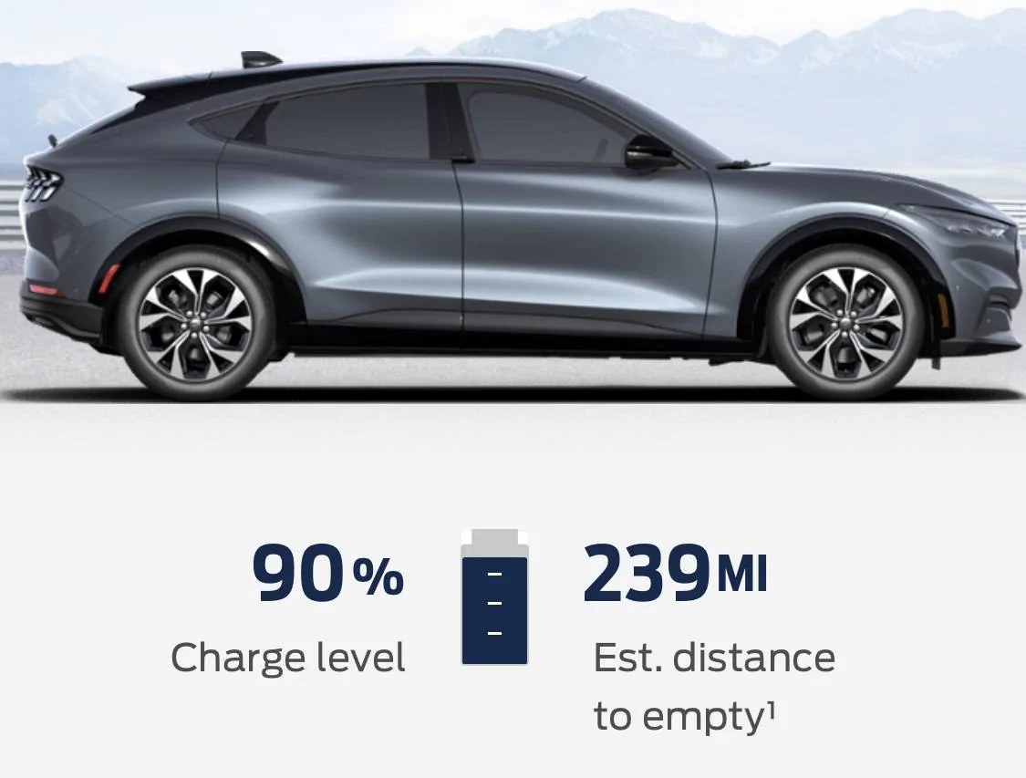

My experience has been that the ā€˜range’ predicted is pessimistic. You may well be able to drive 175 miles or more with 160 miles of predicted range. Try an experiment. Write down the mileage from your odometer and the predicted range at the beginning and end of a few trips. See if you aren’t able to drive more miles than come off your range.
The other commenters are also correct that the cool weather will impact your predicted range. The car knows at least three things. How it has been driven recently. At what temperature. And what the temperature currently is.
When temperatures were in the 40’s & 50’s I was seeing 3 & 3.1 miles per kWh. Now that the temperatures are in the 70’s I am seeing 3.3 & 3.5 m/kWh.
Tonite my ER AWD predicts 239 miles on a 90% charge at 60° F. Extrapolate 265 miles on a full charge. 265/88= 3 m/kWh. If I get the 3.3 m/kWh I expect, my real world range would be 10% more than the pessimistic estimate. The estimate might be higher tomorrow afternoon at 70° F. If I remember I’ll check & post an update.
