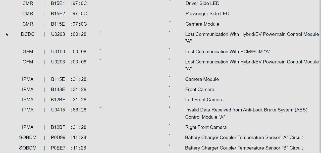

Still waiting for a diagnosis from the dealership ours was towed to after shutting down on the interstate with no restart and dead 12v. The tech that looked at it and started on it 'called out sick' yesterday and no update today.... This was the codes shown right before it shut down, just at a loss of words now

My dealer seemed to have gotten over their lack of personnel (perhaps with some out of department pressure) and emailed that it was fixed and they would deliver it shortly. They said the problem was a bad cell in the 12V battery. Sounds too familiar.

All that speculation and it was just a bad battery?
Oh well, at least it’s a super easy fix.

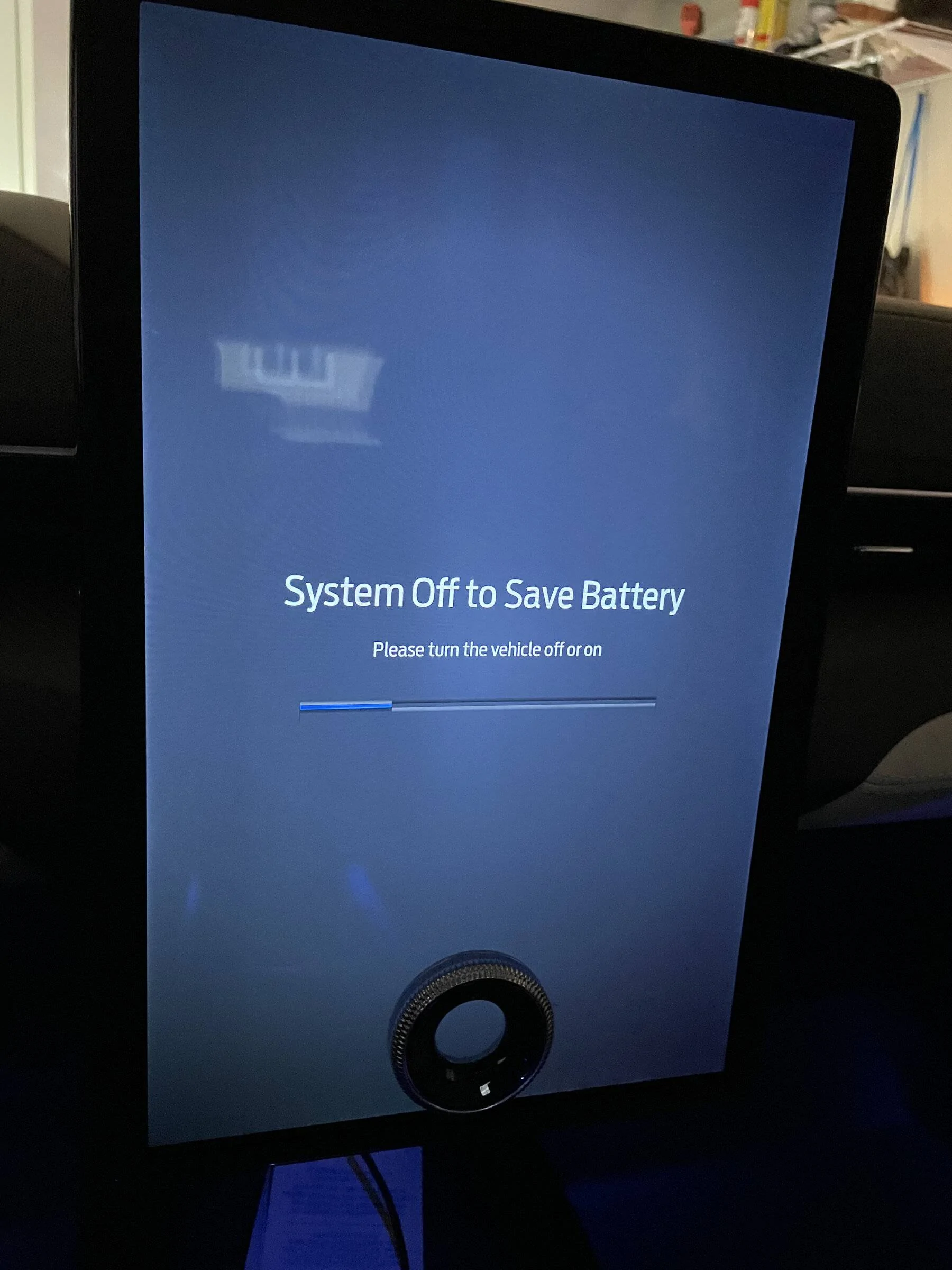

Lately I have been getting this screen when I start my Mach E. 3 out of the last 4 starts. Has anyone else seen this or can you offer any insight. Could the 12 volt battery be having problems
