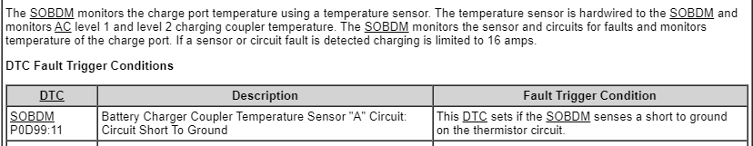

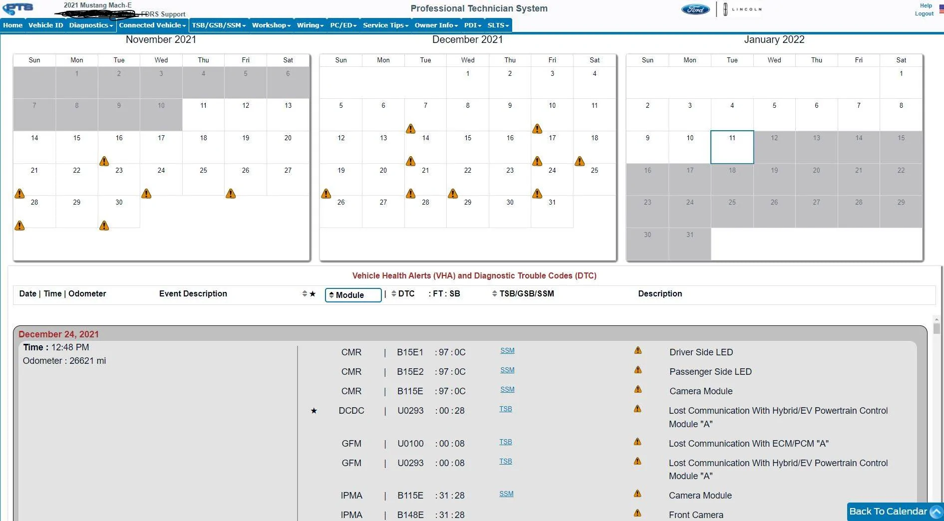

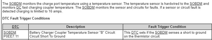

Still waiting for a diagnosis from the dealership ours was towed to after shutting down on the interstate with no restart and dead 12v. The tech that looked at it and started on it 'called out sick' yesterday and no update today.... This was the codes shown right before it shut down, just at a loss of words now
Most of the codes here are pretty common, but I found these two codes for the SOBDM to be the most interesting. These codes say there may be a wiring issue or a bad SOBDM (SECONDARY ON-BOARD DIAGNOSTIC CONTROL MODULE A).
I read all of the TSB's from the service portal and saw that as well. Most of these codes all started after the major update was done the week before.
Even after the new battery was connected, the DTC was not uploaded, states *Payload Not Received for Current Day. This has been the same notice since 12/25.
I am thinking this is a software/hardware issue. Either the software not installing correctly and a good module, a bad module and bad software or correct software but bad module.
I think its a combo and obviously since it is

Update! Sadly, as of today we still have not gotten an answer of what exactly is wrong. 12V battery was replaced and they are going to reprogram all possible modules and update everything again to see if that changes anything. Still in a rental, but fully being taken care of by Ford. Nothing has been transmitted to Fords PTS system with DTC/VHA codes since 12/24 :(
