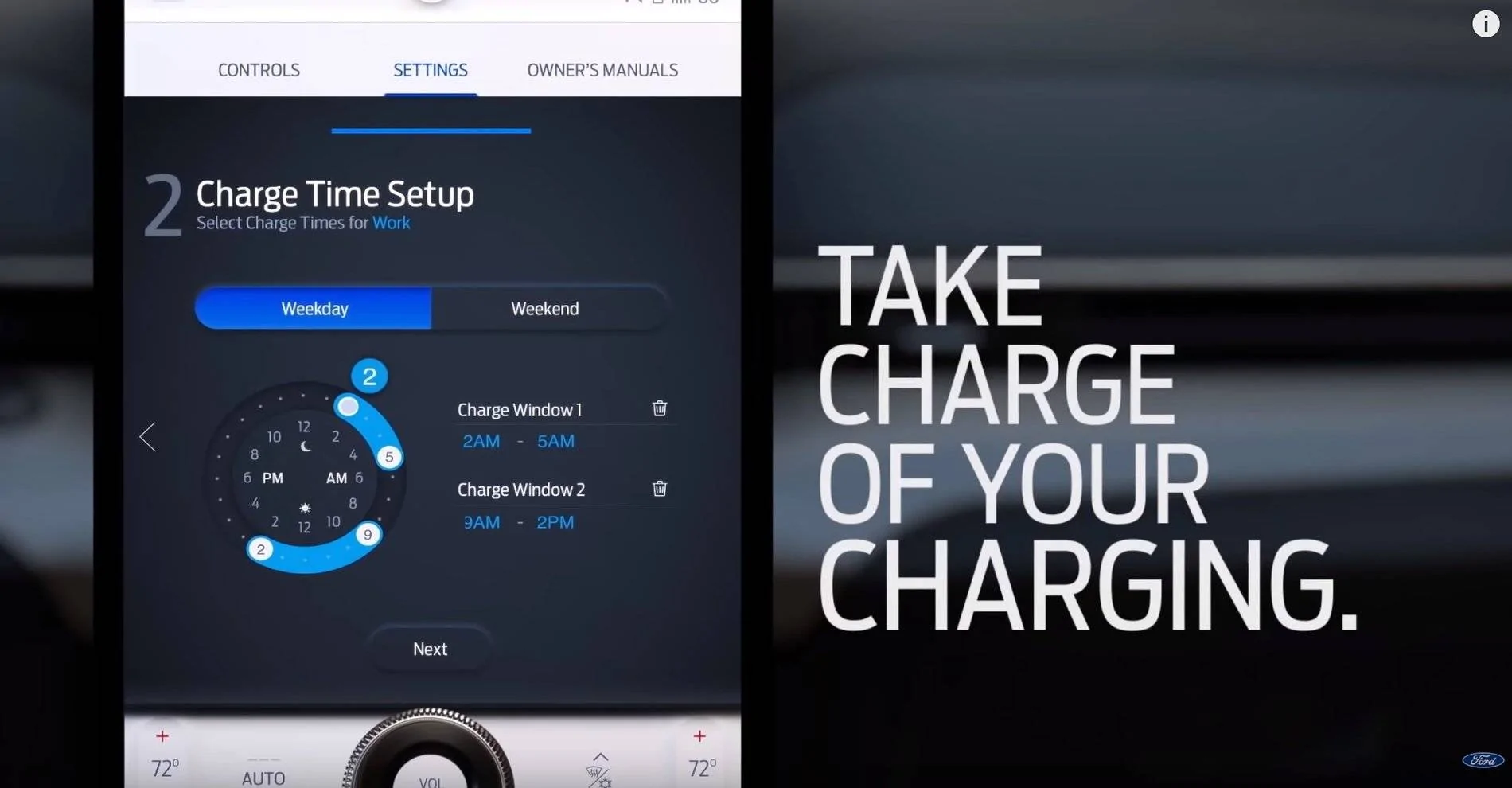

A comment about cold (and/or hot) weather: Both my old Focus Electric and C-Max Energi had "preconditioning" settings. If you have a regular commute you can program in a daily time you leave and a temperature (say 72F). The car will automatically "start" and run the HVAC to get the car to that temp by that time (it also warms the battery if necessary). This feature worked much better on the Focus Electric than it did on the C-Max (we could get a couple of inches of snow overnight and it would all be melted off the windows in the morning on the Focus).
The Bolt doesn't have this feature but you can remote start it (but you have to remember to do so).
Hopefully Ford includes preconditioning in the Mach-E. In one of the videos they do show setting up overnight charging (see below) thus maybe they will also include preconditioning. (Note that it says "Charge times for work"--on the Focus you could setup the times by locations; looks like they are bringing that along too.)

Yes, in Ford's FAQ they've mentioned that departure time preconditioning is a built in feature that you can use if the car's plugged in. Preconditions the powertrain as well as cabin.
