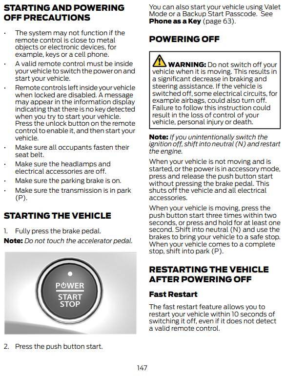

3. Switch on the ready to drive mode.
OK, what's "ready to drive" mode?
Is it just me, or do lots of these owner's manual instructions, well... suck? Gotta read the most basic stuff 2-3 times to really grasp what they're saying, and they leave out the important stuff. Like, where and how to actually jump the car!

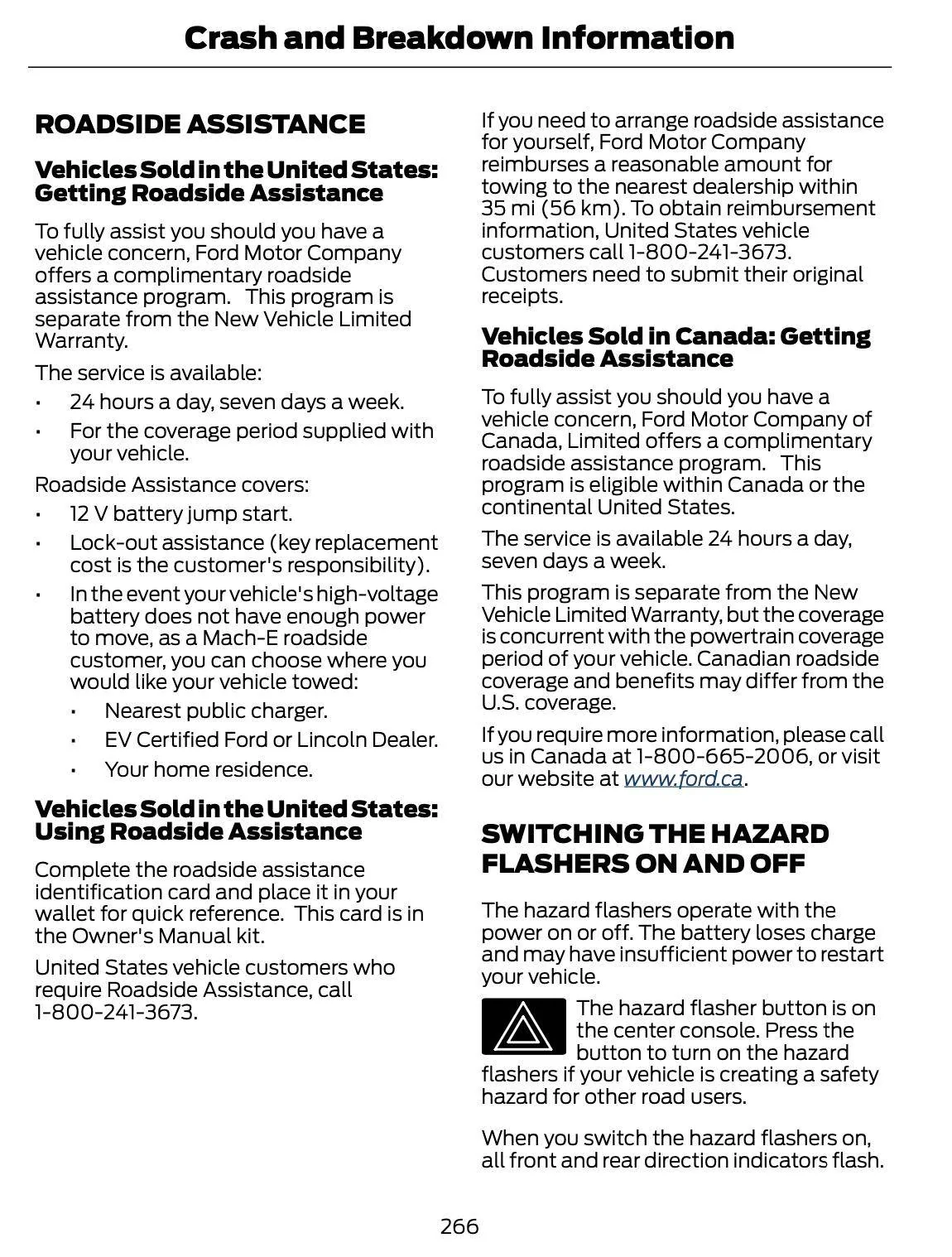

Remember the Mach E comes with free roadside assistance, including jump starts.

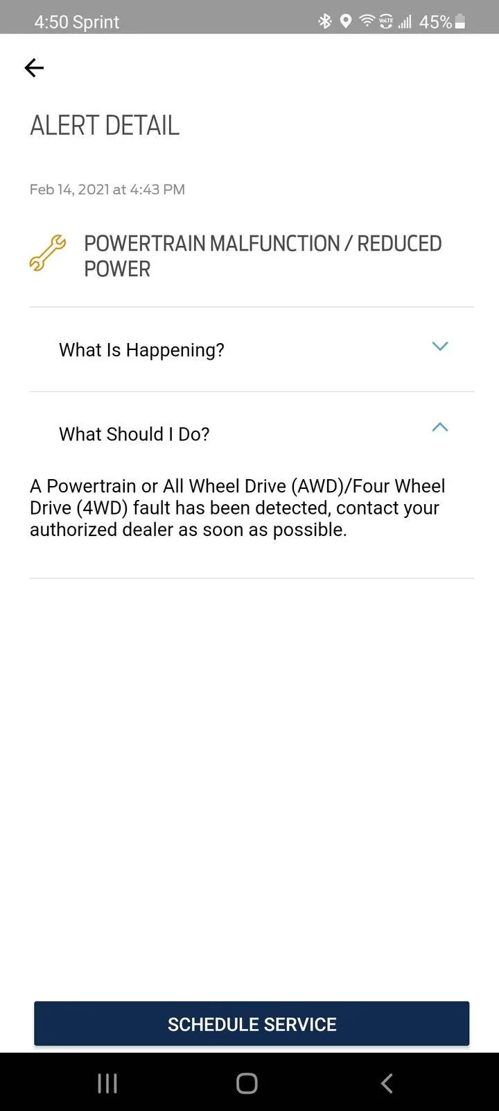

Thank you everyone for the responses and help. I've had this portable jump starter for two years and never used it for my ICE cars. Just had it and charged ready to go. I opened the front bumper panel, connected the reds and blacks, frunk opened. Then the fun part began. Taking off the back panel then windshield washer side panel. What a pain in the ass. Two of the clips are now somewhere under the hood for the back panel.
Jump started a car, my very first time, and she came back to life. HOWEVER, now I have the same powertrain issue Savage has. Made appointment with dealer already online. Thank you again everyone!! Will update when my dealer figures it out.
