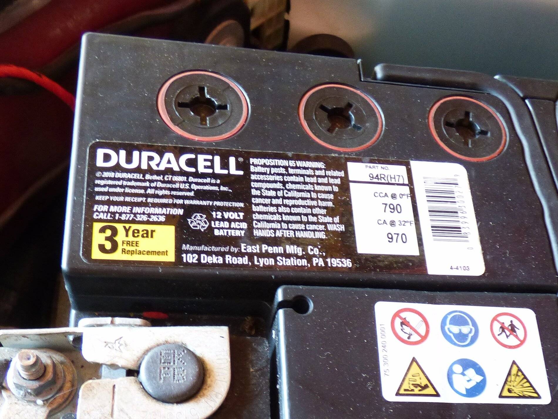

Almost all batteries are made in China these days even the most expensive ones and usually all the brands are made by one or two companies they're just rebadged
No offense, but you state your opinion from a Canadian viewpoint.
This Duracell that I purchased from Sam's Club (Walmart) a year ago was made by East Penn Manufacturing, a huge American vehicle battery maker.
That’s East Penn Manufacturing.
A private, family-owned company operating
the largest single-site, lead battery
manufacturing facility in the world.
Facilities That Power Us.
East Penn is proud to operate a massive, 520-acre single-site battery manufacturing complex in Berks County, Pennsylvania, with world-class facilities that are the most advanced in the industry. We also operate a facility in Corydon, Iowa to help accommodate our widespread growth.
And there are others, you just have to look.

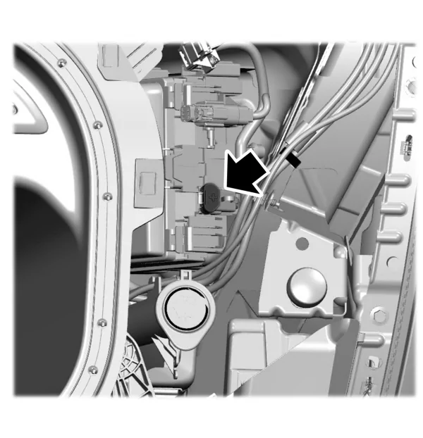

Mark,

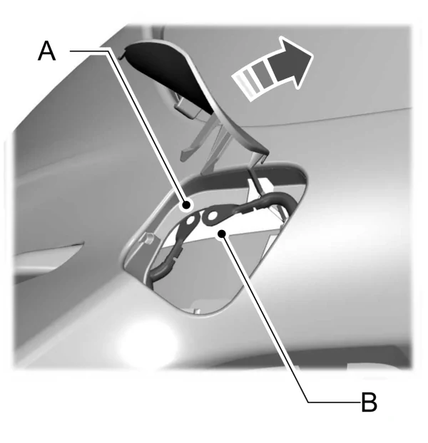

Thought it would be helpful to have a more detailed record of what steps to take to trickle charge.
Which of the frunk panels did you find it necessary to remove?

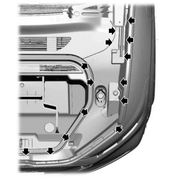

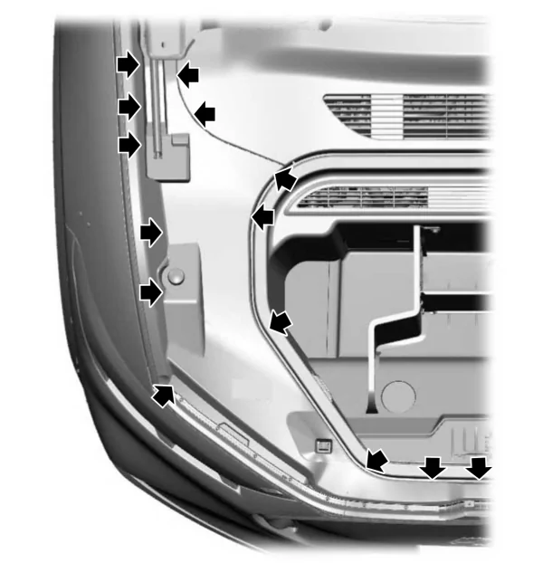

To Open Frunk
  1. Remove the cover at the front of vehicle below the headlight. Press firmly on the top right of the covers edge, then pull the raised section on the bottom left toward you.
  2. Pull both wires out of the opening to reveal both terminals.
  3. Connect the external power supply to the terminals

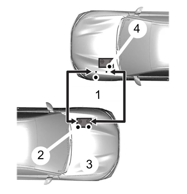

To Charge battery
  • Connect the positive (+) jumper cable to the positive (+) jump point of the discharged battery vehicle.
  • Connect the other end of the positive (+) jumper cable to the positive (+) terminal of the booster vehicle battery.
  • Connect the negative (-) jumper cable to the negative (-) terminal of the booster vehicle battery.
  • Make the final connection of the negative (-) jumper cable to the negative (-) ground point of the discharged battery vehicle.
  • Unlock the driver door. See Unlocking and Locking the Doors Using the Remote Control.
Positive Jump point
Negative ground point

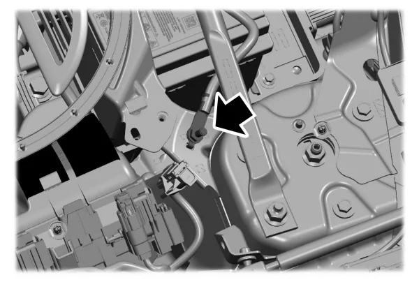

Removing the Rear Luggage Compartment Cover
  1. Start at the rear edge of the left-hand side.
  2. Pull upward at the clip locations shown to release the clips.
  3. Remove the cover.
  4. To install, reverse the removal procedure.
Removing the Left-Hand Luggage Compartment Cover
  1. Start at the rear edge of the left-hand side and work toward the front of the cover.
Removing the Right-Hand Luggage Compartment Cover
  1. Start at the rear edge of the right hand-side and work toward the front of the cover.
I didn't have to use the bumper system as my driver side door was open.
I had to remove the rear luggage cover and the left luggage cover.
One could probably just connect the jumper cables or trickle charger to the jump points you picture. However, in my case, the car was trying to start up whenever the negative cable was attached to the negative post of the battery, so I disconnected the negative cable from the negative post of the battery and attached the negative lead from the trickle charger to the negative post on the battery. For details and images, see
https://www.macheforum.com/site/threads/dead-low-voltage-battery-lvb.3490/
