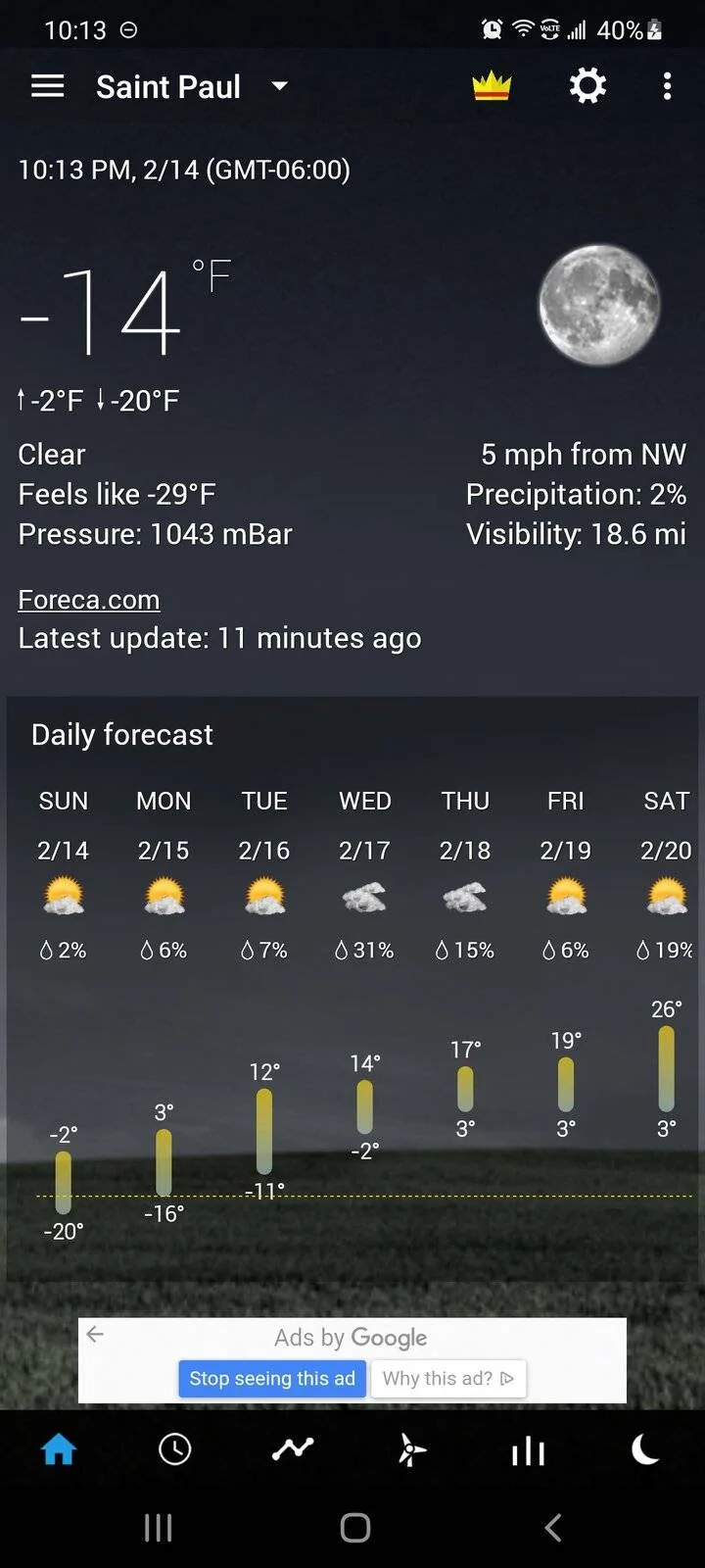

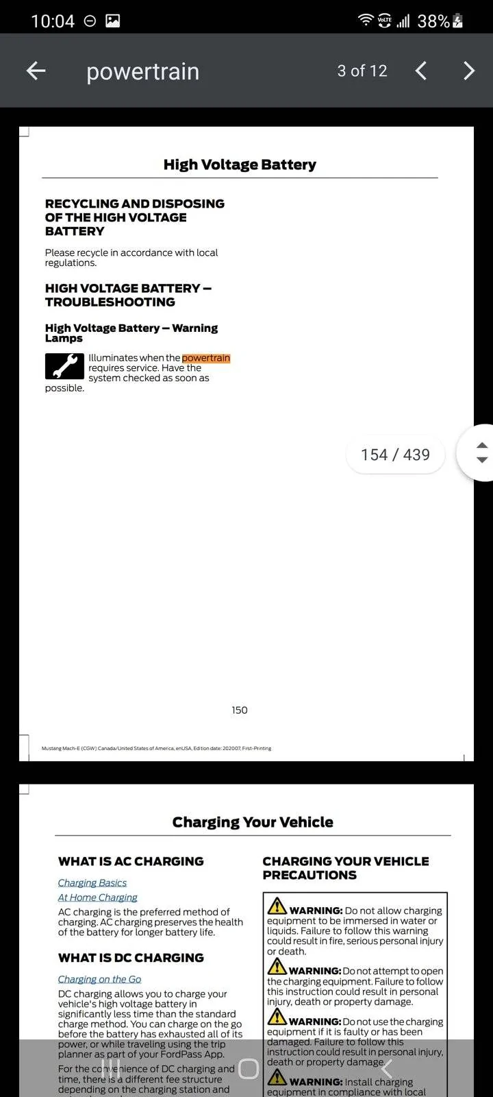

The powertrain light that popped when looking in the manual on page 150 is under the the "high voltage battery" header. Wonder if it wasn't charging the 12v enough. My vehicle was built Jan 9. Did not go to speedway. It had religiously been on the charger every night since I got it Wednesday due to the extreme cold Temps. Outside it has been lows of -22 with a high of 0 for Saturday into Sunday and now Monday. I also had it precondition before I'd go anywhere while still plugged in. It's 22 above in my garage.

Could be the reason. Could also explain why others had issues while driving and the car went into limp mode. They could all be related to a 12v issue. I dont know if the cheapy ebay obd2 scanners can read the 12v level but one way to know if its charging would be to see if theres an increase in voltage on 12v while plugged in vs while its just sitting.
If the 12v dies, its the same as your alternator going out since there is no other way to run the electronics in the car. So the errors you guys are seeing could be a low 12v. At this point the dealer will be able to figure that out easily. It just sucks you guys have to go through this.
