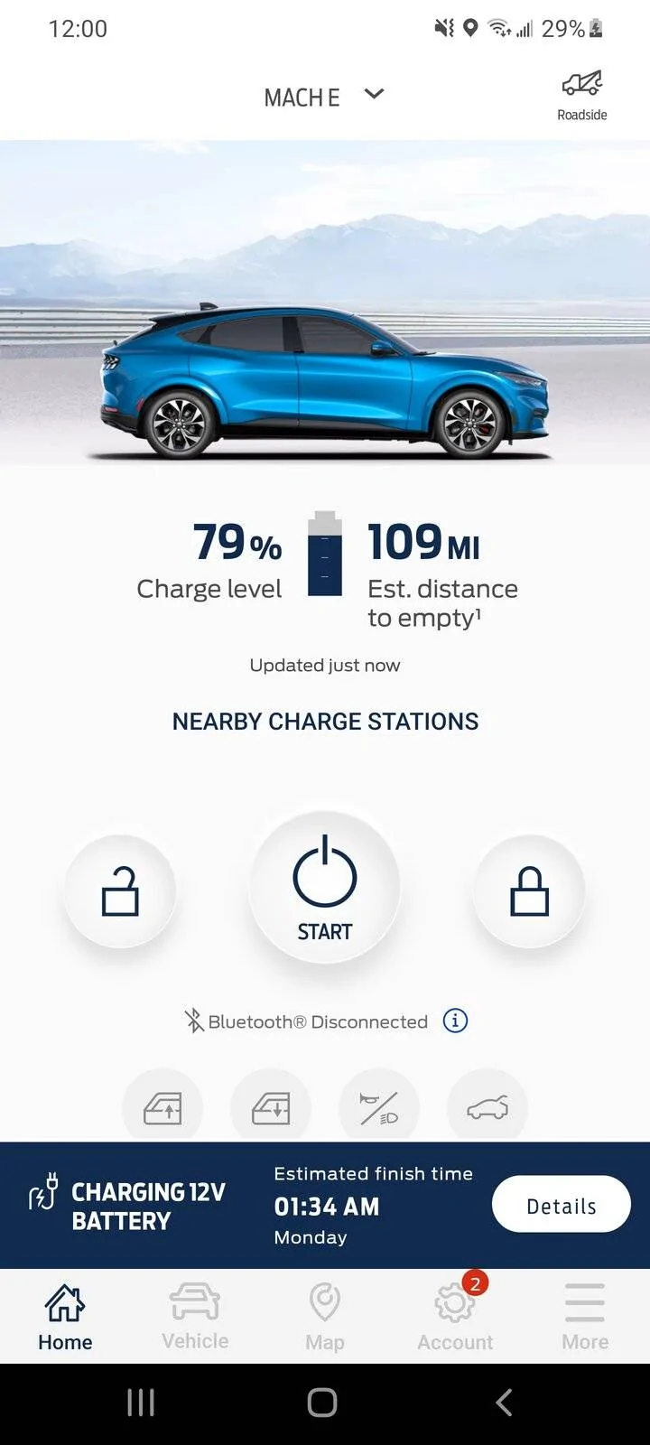

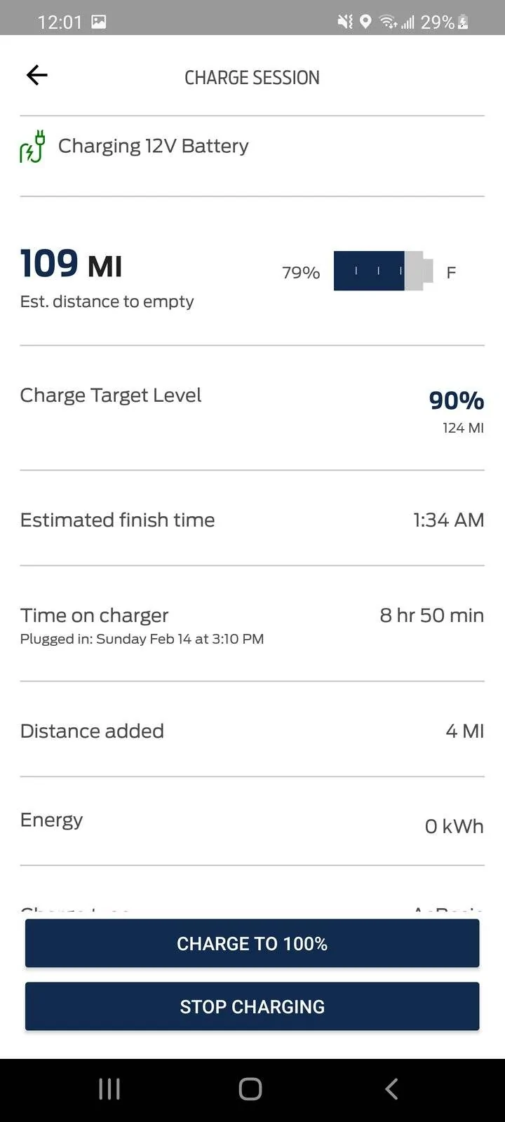

Strangely enough, I got this notice last night.
Ford Mustang Mach-E Deep Sleep Mode - 12v battery drained dead [update: Mach-E jump started] Screenshot_20210215-000053_FordPass
Ford Mustang Mach-E Deep Sleep Mode - 12v battery drained dead [update: Mach-E jump started] Screenshot_20210215-000124_FordPass
