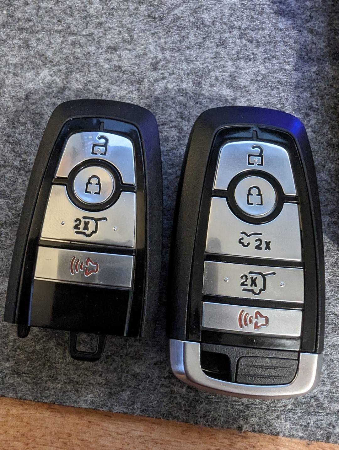

Huzzah, I got tired of waiting and picked up one of the $100 ebay Lightning ones. To anyone swapping out the hatchback button, if it doesn't quite fit it seems the Lightning key has ever so slightly smaller ones, I used a file to very lightly trim up the edges (of the button and the black frame) and it fits/clicks a bit better.

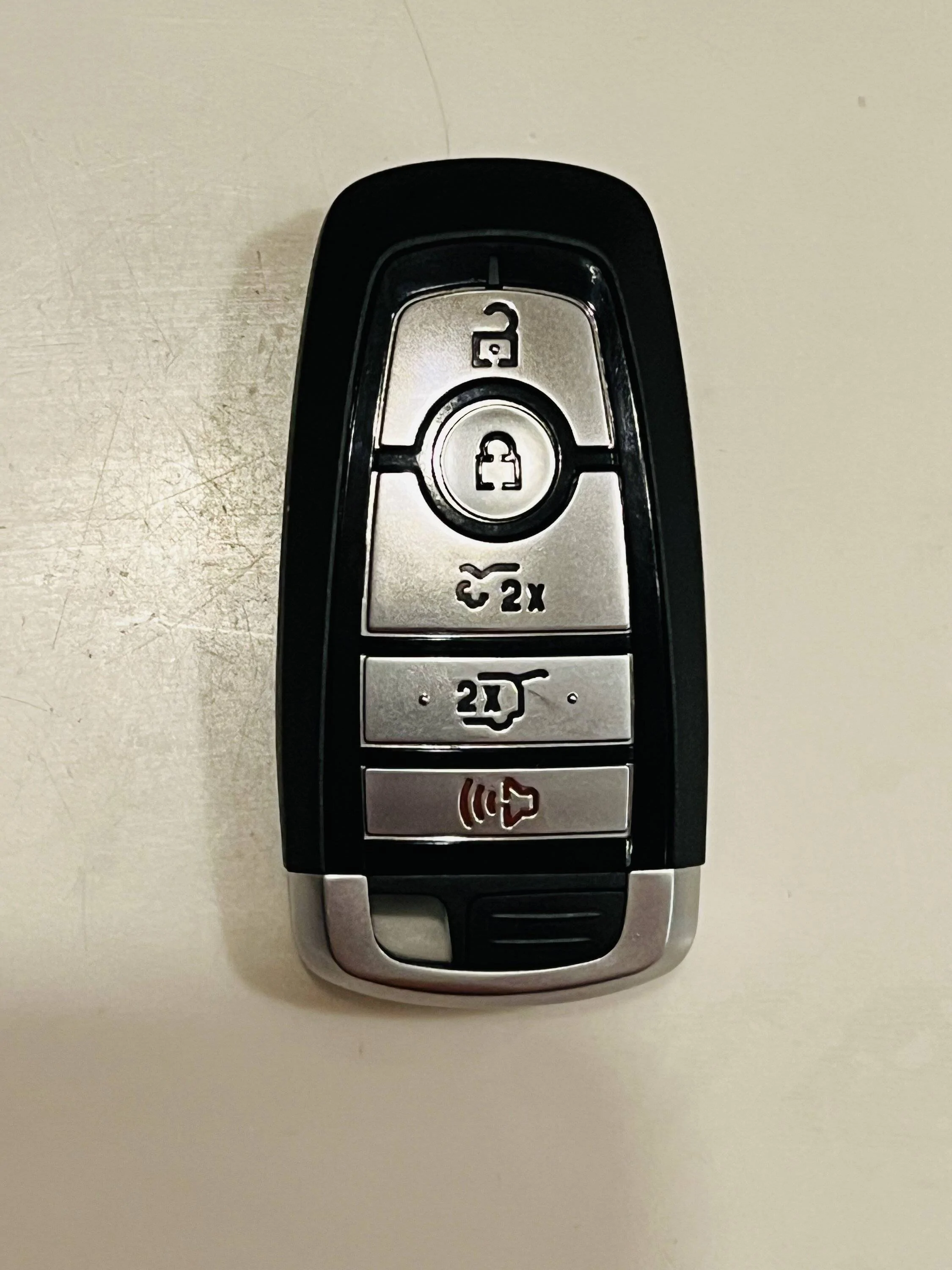

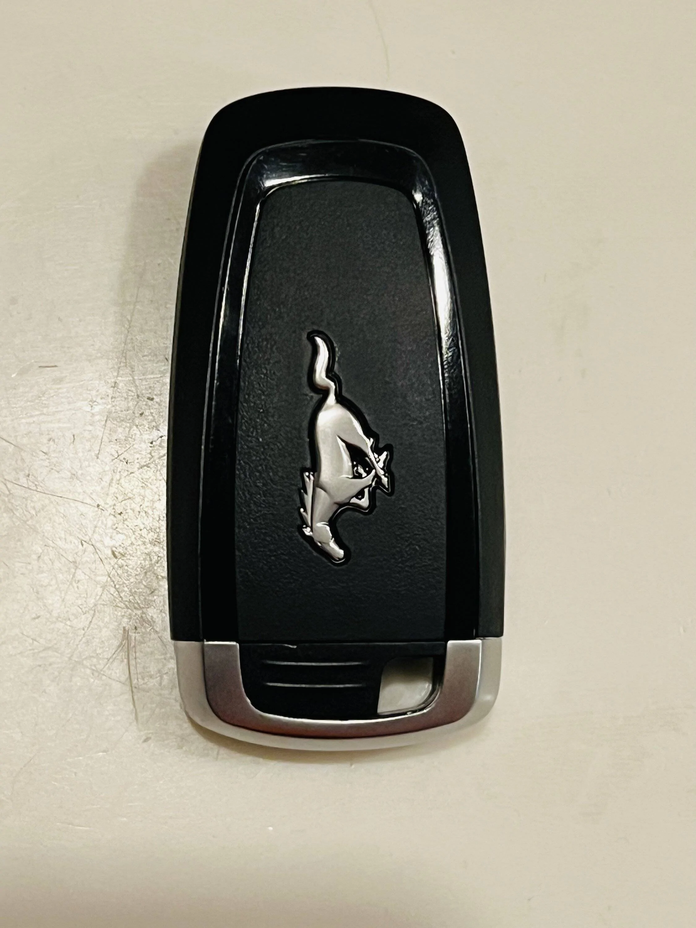

So I bought the converted one on eBay with the right Frunk and trunk key and the Mustang on back. Worked perfectly only critique I would have is the Mustang on the back is the regular one not the MachE version. Other than that flawless. Easy to program and for me worth the premium for the customization.

Mach-E fobs have actually come with both versions of the pony on the back. My original fob has the same silver pony.

Interesting 2022 has the striped Mustang logo, like the one projected on the ground. My 2017 GT had the solid silver.

Both of my 2021 Job 2 keys have the silver pony. ?‍♂?
