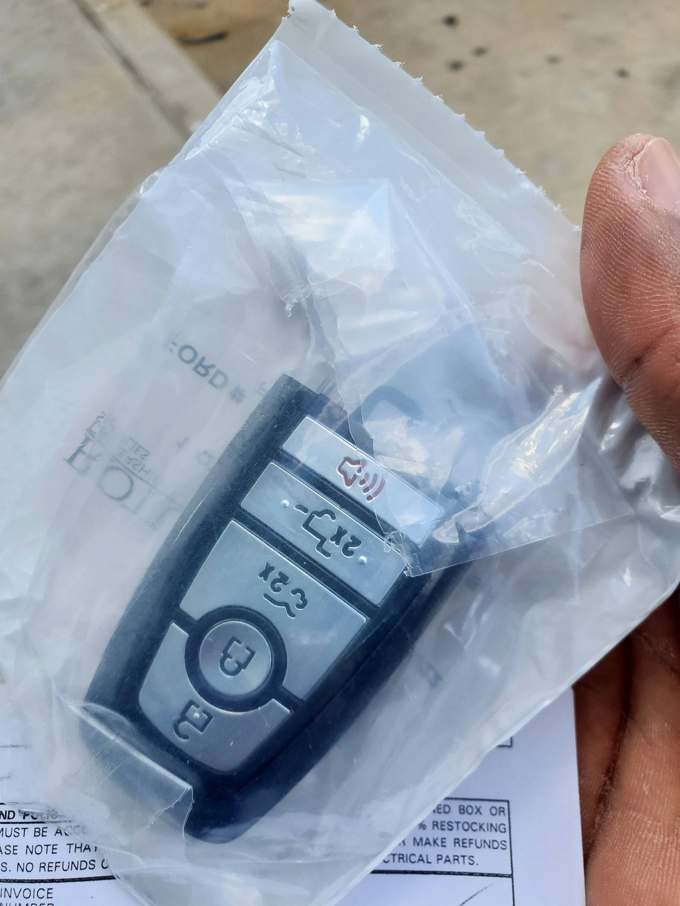

I ordered it, but it didnt come with the key blank. Was it supposed to?
Depends which part# you ordered. If it ends with EB it comes with the key blank. If it ends with EC, it doesn’t. The one I ordered from keylessentryremotefob.com did come with one.
I tried ordering at the counter with a part jumber, but they couldn't find anything. I then had them use a VIN from a random Lightning and they then saw the number 164R8304 and ordered that. Serves me right for not reading the OP fully before purchasing. I also paid way more than you out-of-pocket, even after using my FordPass points. I didnt know there was anothet option.
If you don’t want to move the key blank from your MME fob, they can be had inexpensively. Don’t buy it from Ford.
https://www.amazon.com/gp/product/B076KX272D/ref=ox_sc_act_title_1?smid=A392A0WD8JJN37&psc=1
https://www.carandtruckremotes.com/ford-key-blade-164-r8168.html

My $.02… just buy the replacement shell from Amazon if you want the key blank. You will also get the hatch button that you can replace if you don’t like the F-150 tailgate icon.
