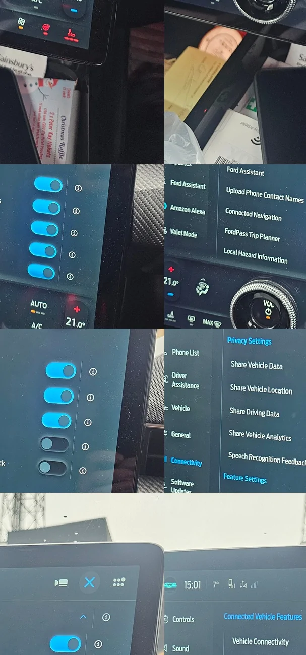

Ive no idea how to turn that on 🤣
On the touchscreen, go into the vehicle connectivity settings, there should be one called "Share vehicle data", make sure that's turned on. Restart the car, go for a short drive, and then ask Javier to check again.

Ford Mustang Mach-E Door Sensor Fault - which one? 20251204_150154
Share vehicle analytics was turned OFF so ive turned that ON
But Share vehicle data was already ON ive left that ON

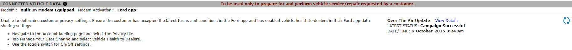

Strange. Just checked again and the info it is reporting is still limited. This is what it says:
Ford Mustang Mach-E Door Sensor Fault - which one? 1764866032152-1w

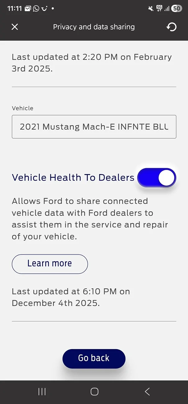

Ford Mustang Mach-E Door Sensor Fault - which one? Screenshot_20251205_111133_Ford
This message was turned off, ive turned this on. This wasnt in the car it was online in the app.
Not sure if that now helps 🤣 thanks and sorry again.

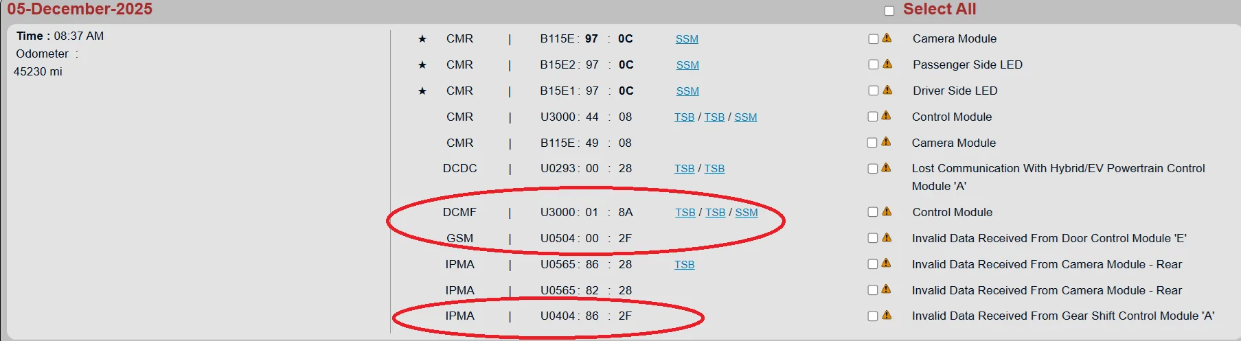

That indeed did the trick. The codes it is reporting are below. Tagging @Mach-Lee and @Mike G as I feel they are better suited to help you with this than I am. The codes circled in red are the one relevant to your cause. The other codes are either stored codes or in the case of the first 3 CMR codes, they are saying your driver facing cameras may be blocked. If you are not having any driver assist or Bluecruise issues, I would ignore those.
Ford Mustang Mach-E Door Sensor Fault - which one? 1764944460051-0k
What is interesting is the TSB's referenced by the DCMF U3000 code also have to do with driver assist issues and not the door itself (I attached the TSB's and SSM's anyway). The DCMF U3000 code has a fault of general circuit/electronic failure, the GSM U0504 code has a 00 fault type which means no fault type available and the IPMA U0404 code fault type is for an invalid signal between the IPMA and GSM.
Going back 60 days which is how long codes are stored on the cloud 4, these 3 codes have been active faults the entire time. I am unable to provide a diagnosis based on this info, but hopefully one of these guys have come across this before and can point you in the right direction.

If I remember correctly, I believe the DCME is the driver's door (LHD), DCMF the right side passenger's door, DCMG the right rear passenger door, and DCMH the left rear passenger door. So they were ordered starting in the driver's seat and going around clockwise.
264
11,484
25,415
The DCMF U3000 means there is an internal problem with that module. I would first attempt to reprogram it. If that doesn't work, then the module should be replaced. DCMF is the front passenger door.
The CMR (driver monitoring camera) should also be updated or reprogrammed to clear those faults. If that fails, then the CMR should be replaced. This fault may prevent HF BlueCruise from working.
