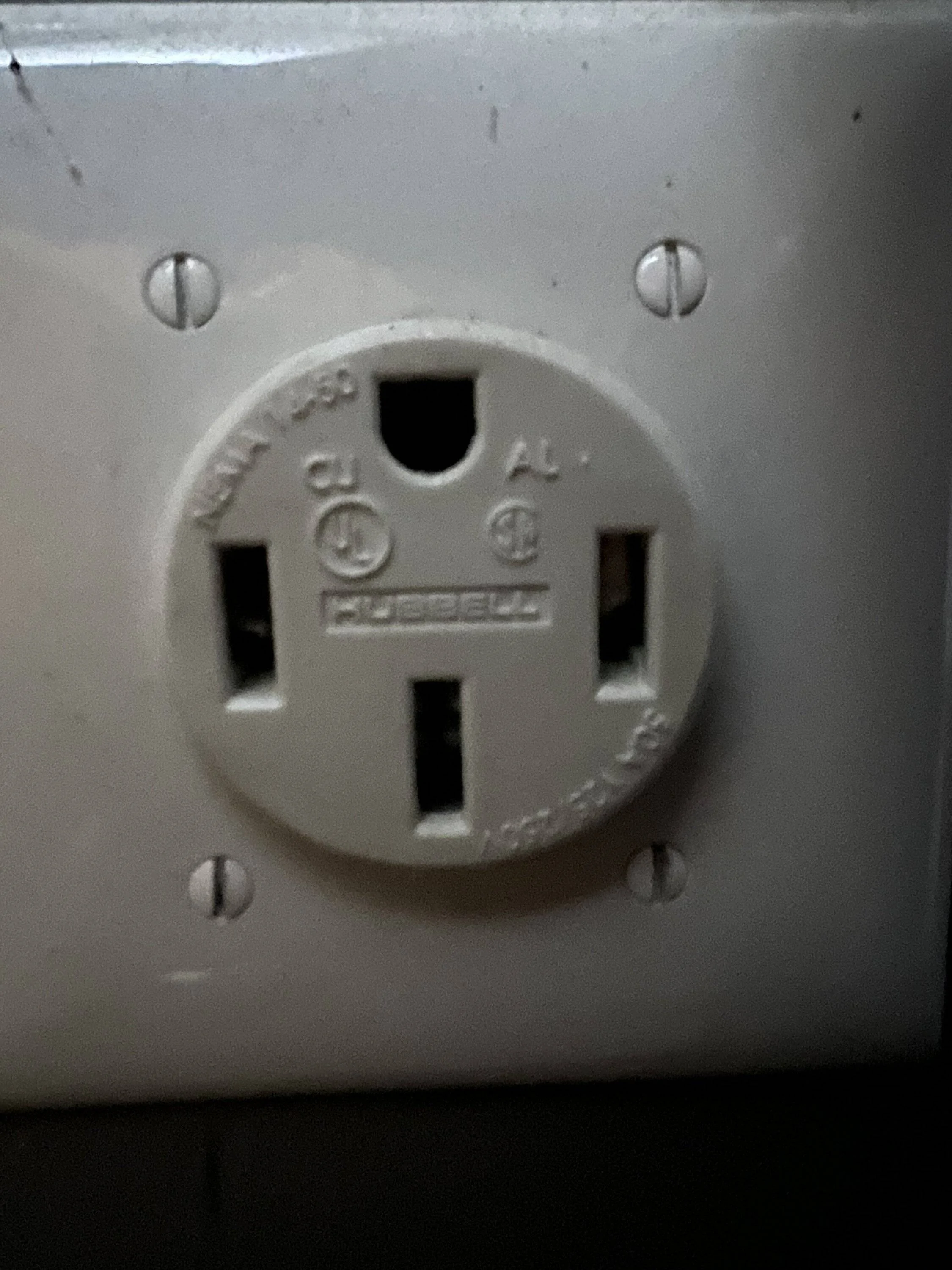

This thread got me curious as to what our electrician installed, and it's a Hubbell. Am I good? Looks like it has the certifications on it, but not sure if they have different models and this one could be the generic version or whatever.

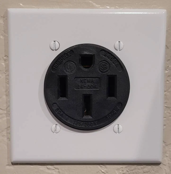

That looks to be the cheaper receptacle. Look at mine and notice the distance from the receptacle to the cover screws.
I do have to give props to your Electrician. I have the same habit of making my cover screws have the same orientation as well.
Ah darn, I imagine it's still a decent outlet at least, but may be worth checking on an upgrade since this has been installed for a few years now and probably could use some maintenance checks anyway. Charging the C-Max Energi or Focus Electric I wasn't too worried, but the Mach-E can pull a lot of power for a lot longer.
Thanks very much for the response!
