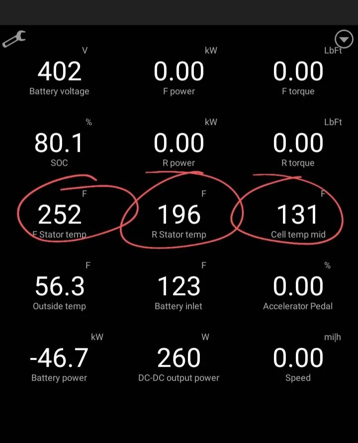

Are you able to view the actual temps of the motors, not just the oil temp?
On my Y, the front motors can hit 252F/122C, rear motors 196F/91C. Battery pack during L3 charging is typically max 131F/55C but I've seen it hit 135F/57C once. The car wants the battery to be at least 115F/46C l, which is when it has the Stator motors stop generating heat.
Ford Mustang Mach-E Explained: The Thermal Problem with Mach-E 20211111_155658

If the issue is, as Kyle explained it, the motors and the inverters are being pre-emptively nannied to prevent overheating, then the engineers have put in some serious margins that theoretically could be dialed back to provide more power for longer.
@breeves002 are you ever seeing high temps in the pack? The point was made in the podcast that the MME pack is huge and has a lot of thermal inertia so it shouldn't be the weak point.
I think the highest I've seen the pack temp is around 100F, and there is a CHGACT (not sure what part that actually is) that i've seen hit 114F. And thats after a DCFC.
Typically if I haven't charged and just driving it averages between 75F-90F in the pack.
