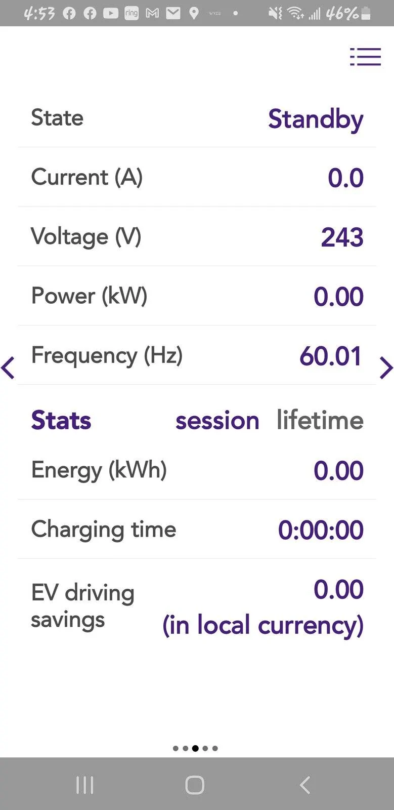

So after a long car ride yesterday I got home with 12% battery. I figured I would give the 240V a try and it worked!! I’ll post screenshots of what my JuiceBox showed but after about three hours I had to go pick up my daughter and the car was at about 25% charge. After picking her up, I came back home and it started charging again on the 240V. I am leaving town so I also was able to change the max charge to 60% and it uploaded the setting to the car just fine. However I did notice a message in Ford Pass (not the car) that I was charging outside of my preferred hours. What is weird is that I never set up charging or departure times.
I emailed the Ford Mach-E team last night to tell them that my car is now charging. They still have the token installed on my car, so they should be able to see the data and determine why it was now charging. They emailed me back and said they would forward my email to the battery and charging team.
Hopefully this provides them more data to compare. I am still waiting the new BCM that was ordered and they think they can install it 4/2. I still think this may be a combination of software and hardware issues.
Crazy!
Is your car still charging ok? I let might get down under 10% but still didn't charge. I'm anxious to see what the Mach-E team comes up with because I feel like we are all chasing our tails here.
